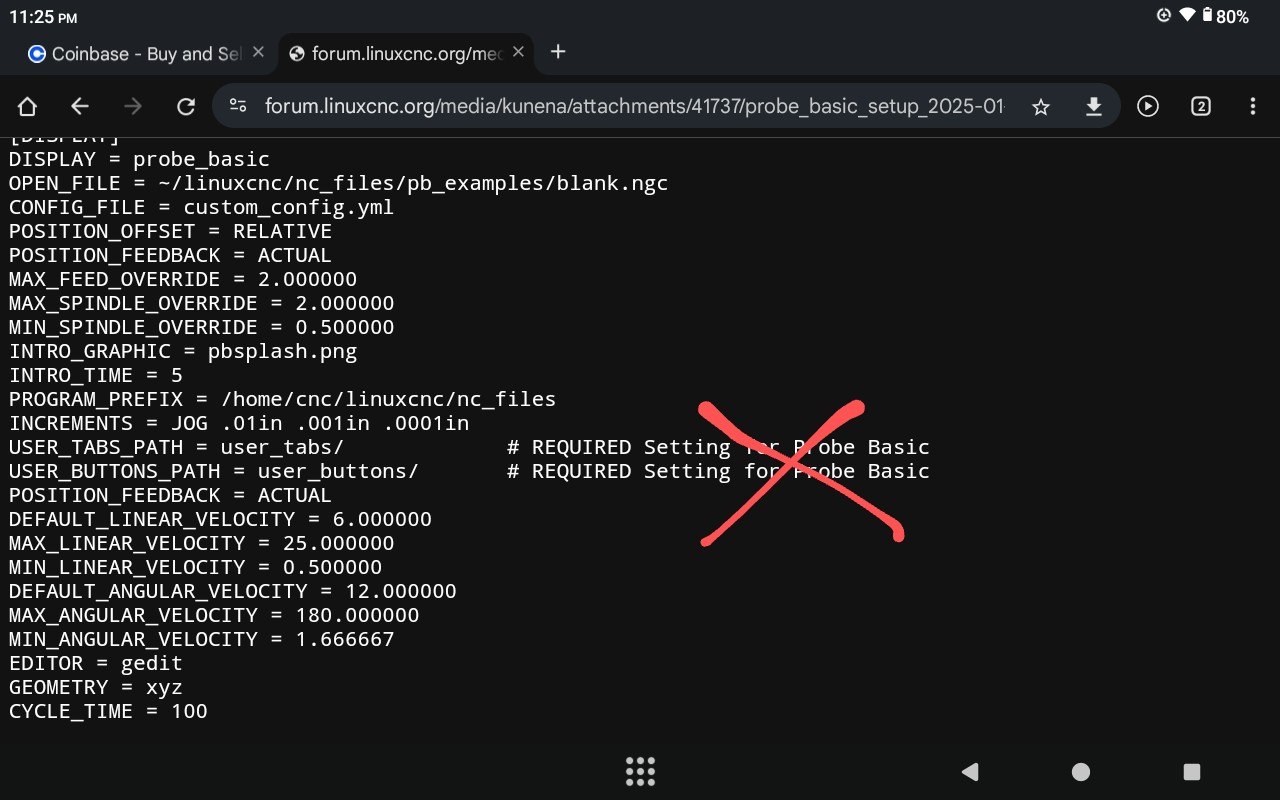

I am still getting can not start display probe basic. I have gone through the configs several times and started fresh with my ini and hal files and still can not get it to launch via Linux CNC launcher with my setup files.

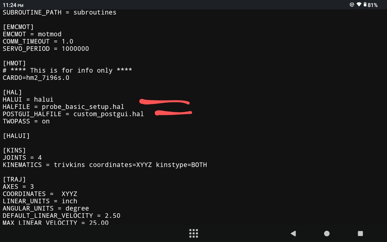

for clarification, if the file names of the files you uploaded are the ones you intend to use, you need to use them in the ini file call as shown below:
Replied by Lcvette on topic Probe basic Install errors
Lcvette, Sorry, when I wrote this originally the site was having issues and I could not post. seems I forgot to add them when I tried to post the second time.
Let me know if you need anything else!
All the help is appreciated!
[HAL]
HALUI = halui
HALFILE = probe_basic_setup_2025-01-09.hal
POSTGUI_HALFILE = probe_basic_postgui.hal
TWOPASS = onPlease Log in or Create an account to join the conversation.

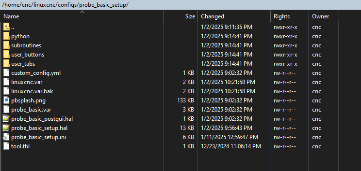

Lcvette,
Thanks for the help.
I'm unsure why the file names on the forms now have the 2025-01-09 attached. It must have been added when I uploaded them. They match what I have in the ini file except for the postgui file name error. I thought I had changed that one. I have made the suggested changes and still can't launch Probe Basic. getting the error "Can't execute DISPLAY program probe_basic "
