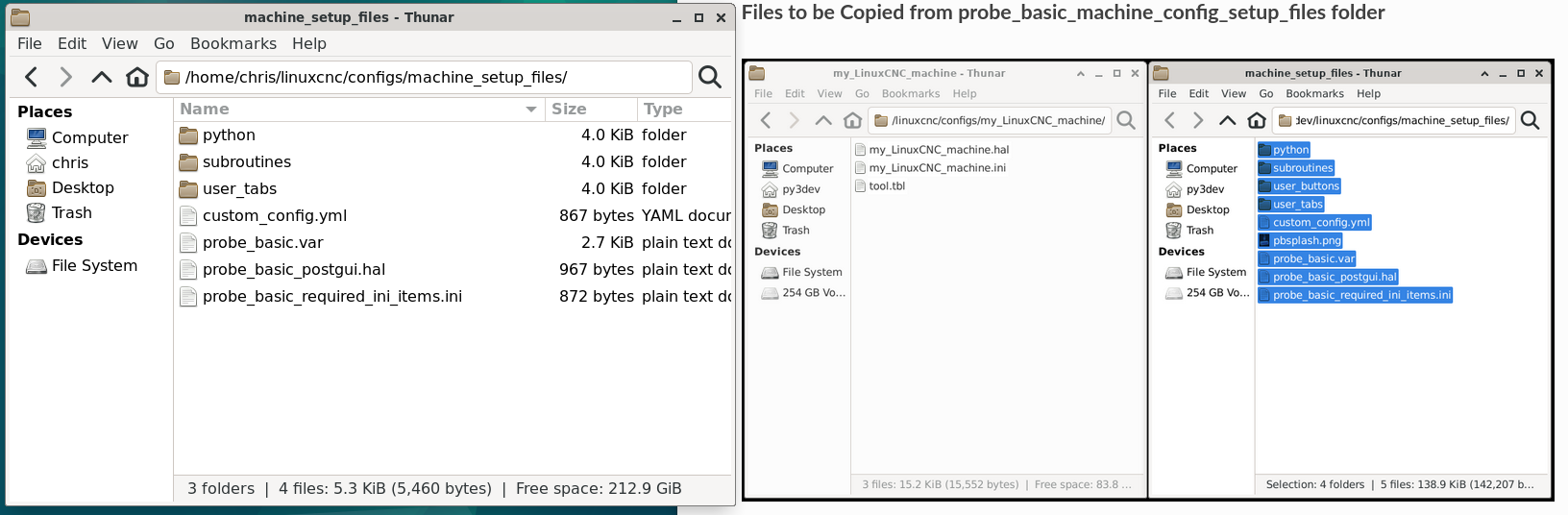

Lcvette spent a few hours helping me last night and I learned a ton and made notes and screenshots so that I can do it again later, if needed. The linux kernel was not a realtime version, after following the install directions, so he guided me through fixing that and manually setting the network card and doing auto login for debian. I had done last two items before but did not remember how, and I had no idea how to fix the kernel, but did realize it wasn't listed as rt when seeing it while working through different screens. It was great to have someone walk me through doing it in a way that I knew would be correct. I mention all this so that if someone else finds this thread and has the same problems, they can learn a little more about their situation.
Now, my system is up to date and I was able to get a working Axis installation going. It all seems to run properly, but my ping to the mesa card is high so I will make a new post to ask for help with that (it isn't stopping me from continuing work on the machine setup).
The next steps are to copy the sim.var file and then to copy other files and folders from the machine setup directory.
My "machine setup directory" is missing “user_buttons” folder and the pbsplash.png file.
The left is my folder and the right is from the instructions page for installing Probe Basic.

if you are on the stable version it will not have the user_buttons feature yet if memory serves. that would be in the develop version for now only. you can leave it off and the pbsplash you can copy from the git directory if you would like that as the splash screen.
github.com/kcjengr/probe_basic/tree/main.../machine_setup_files

Stupid me........Your directions did say the folder was needed for the dev version, but it didn't sink into my mind with all that I'm keeping track of. Since it was mentioned in the stable directions and photo, my mind said it was neeed. Thanks for the link to the nicer splash screen.
