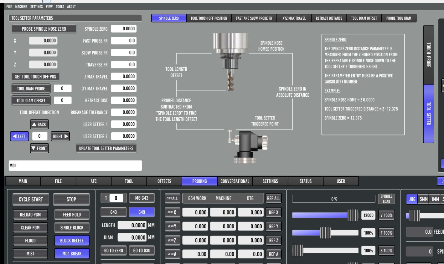

Small question, after I restart PB I lose the values in the Probe screen and the settings for the Tool setter (like spindle head distance).
How are those retained normally? It didn't happen at first, so must have happened while editing .HAL and .INI.
Tool offsets and WCO do get saved, no issue with those.

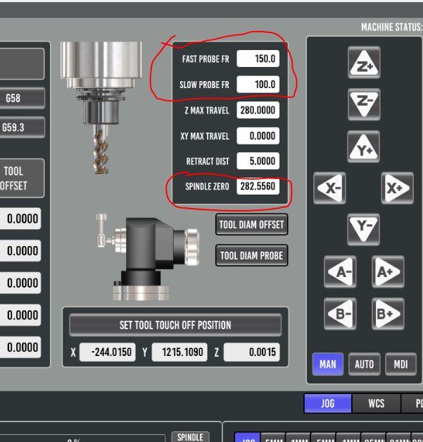

16 Feb 2025 11:08 #321715
by IB_CnC
Replied by IB_CnC on topic Losing some values after PB restart
- Lcvette
- Posts: 1682
- Thank you received: 784
16 Feb 2025 11:20 #321720
by Lcvette
Replied by Lcvette on topic Losing some values after PB restart
You are on a very old version, chances are you have the wrong subroutines for the version you are on. Update to the latest stable version to resolve.

16 Feb 2025 12:53 - 16 Feb 2025 12:54 #321732
by IB_CnC
Last edit: 16 Feb 2025 12:54 by IB_CnC.
- Lcvette
- Posts: 1682
16 Feb 2025 13:00 - 16 Feb 2025 13:02 #321733
by Lcvette
excellent, glad to hear it!
fyi, your jog increments can be set in the ini file to avoid them being stacked on top of each other like that. the stock increments are typically more than are needed for actual functional use. I find 3-4 increments plus jog are sufficient for all situations.
