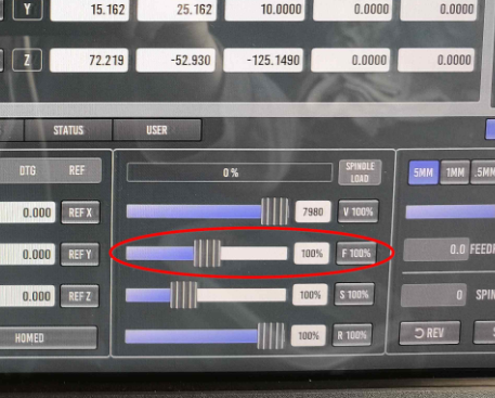

Hello everyone, I have another small problem again. My machine does not have an active feed slider for some time now. Normally, after start and homing, it is active but during a cycle run I cannot adjust the feed with the slider. What is the reason for this? I know that this has worked before and I don't know which setting has been lost.In the INI, I have MAX_FEED_OVERRIDE = 2.000000Does anyone know anything about this?
ChatGPT told me to add two entries in the HAL file:
net feed_override <= halui.feed-override
net motion_feed_override => motion.feed-override
I made these entries, but the machine does not start - error - halui.feed-override does not exist...
What can I do?
Thanks for every hint!
Greets, Hanno

For the UI you do not need that, it's coded and the only setting is the ini. You may have a conflict if using an external source besides the screen sliders. I would remove any external source and check if functionality on screen returns.
Also try the sim to verify it still has functioning override sliders.

I found the reason for this. He's using my tool probe routine and I forged two lines in it.

I tested the V.5.01 and voila - it works as it should and the Feed Override Slider is active again! Thank you for detecting that problem in your routine and fixing it finally! You are my hero, my machine is now ready for the first chips. (not really, but mainly)
Thanks a lot,
Hanno
