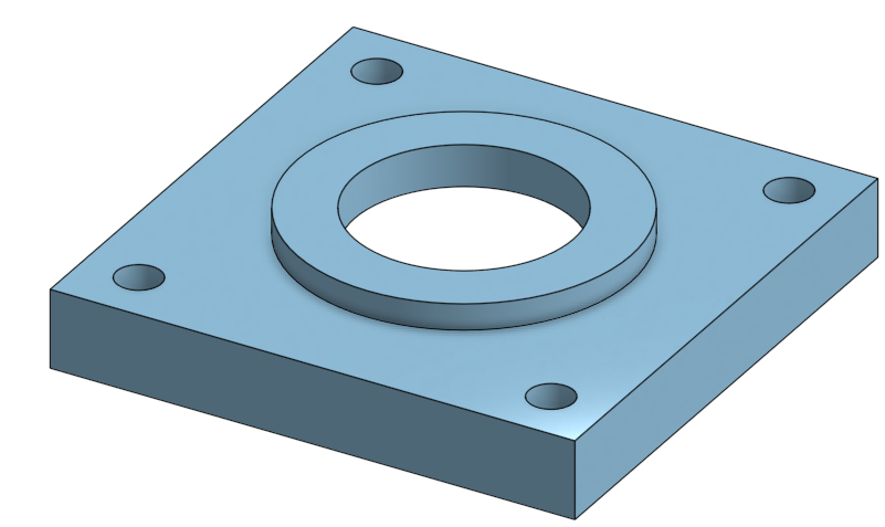

24 Feb 2025 00:54 #322465
Replied by rodw on topic Move Machine to inside soft limits when Probe Basic on
Back to the centre home position, you touch off using G54 offsets to achieve this in the work piece
linuxcnc.org/docs/2.4/html/gcode_coordinates.html
Here is an example part where you would touch off on the centre of the part as everything needs to be concentric of the centre bore.
This does not affect the machine home position
