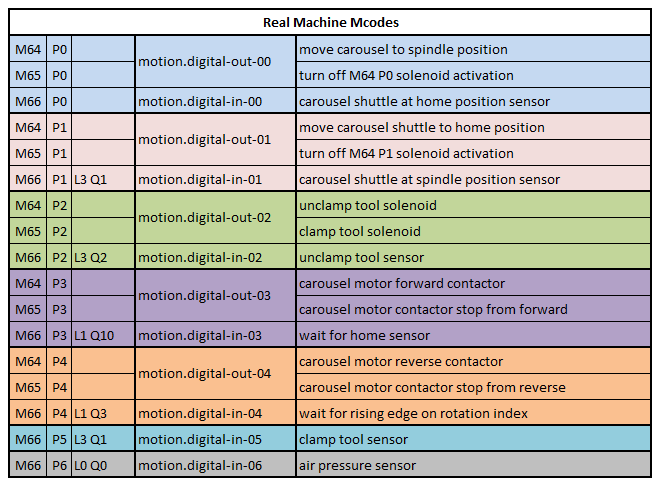

Those are just templates, you need to define and edit for your machines sensors and requirements. My machine uses two sensors one for clamped and one for released because it's only reporting when the plunger is actual at the released or clamped height. If you're have just one sensor that's high or low, than you may need to remove a line from the macro. The best thing to do is to map everything out and then review your sensors and the macro sensor inputs and ensure everything is accounted for.
- Lcvette
- Posts: 1682
- Thank you received: 784
09 Mar 2025 19:41 #323579
by Lcvette
Replied by Lcvette on topic Can't succesfully release Tool (according to Probe Basic GUI)
I made one for my machine, but i don't recall what was changed. you can use it as a template to create your own machines requirements and make sure the macros are correctly setup. the docs explain the different M-codes for DIO.
linuxcnc.org/docs/stable/html/gcode/m-code.html#mcode:m62-m65
linuxcnc.org/docs/stable/html/gcode/m-code.html#mcode:m66
again these are changed to work with my machine and may not completely align with the sim macro requirements:
- Lcvette
- Posts: 1682
09 Mar 2025 19:45 #323581
by Lcvette
changing LT is incorrect. you should instead rewrite the portion of the macro to correctly wait for the available signal. ie use the correct M66 Pn input so the macro verifies the drawbar is in fact in the correct position.
