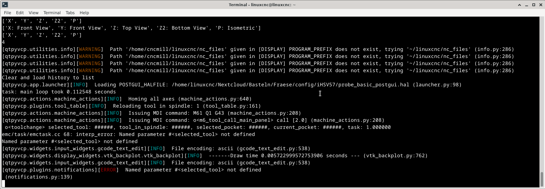

I am currently writing my own tool changer script for my rack. However, my problem is that the parameters like "#<selected_tool> or #<tool_in_spindle> are not forwarded to the script. I can see that these are normally handled by the stdglue.py script. The "standard" tool changer script also doesn't work (with the same issue). If I hardcode the #<selected_tool> to 1, I get the error for the next variable (<tool_in_spindle>).

I attached my tool changer gcode and the error from the console.

Okay, it seems like the std glue.py is not called at all (I added debug messages in between) so I had to revert back to the standard linuxcnc # number variables. However, I now get the error "bad number format (conversion failed) parsing". Unfortunately, without line indication.

Okay, I found the issue why the PB remapping was not used. The python had to be activated in the ini as follows.
[PYTHON]
PATH_PREPEND = python
TOPLEVEL = python/toplevel.pyPlease Log in or Create an account to join the conversation.

great! glad you got it working. always refer to the sim configs if you get stuck, everything has been done there to test functionality.!
