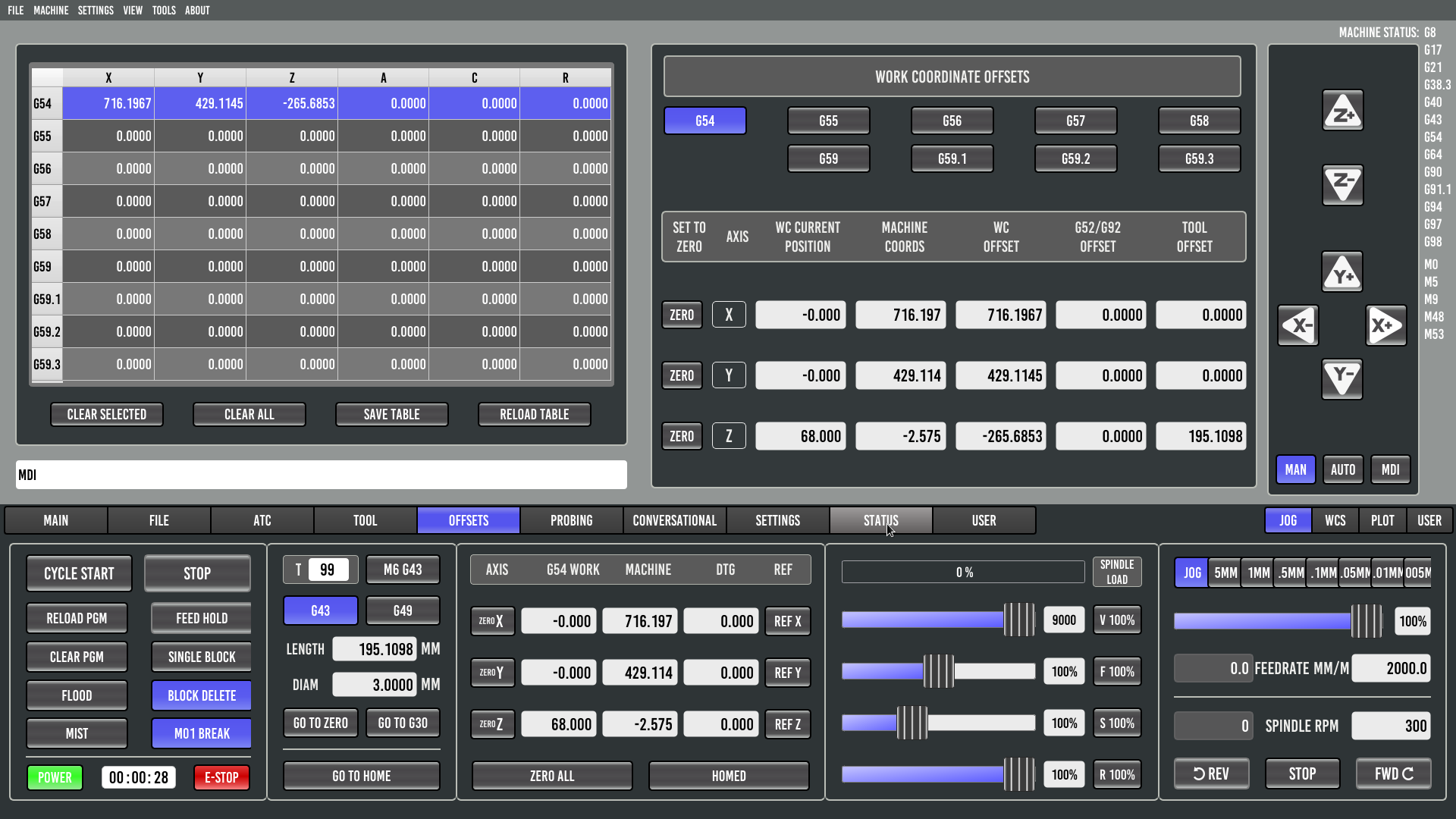

Hi
I am currently setting up my 3D Probe. I declared the probe as T99 in the table. In addition to that, I set Variable 4012 in my *.var to 99.
However, when I command the Tool to be picked from the Toolrack, I get the message "T99 not found in carousel". All the others (I actually tested only Tool 1-7) are working. Is there something I am missing?

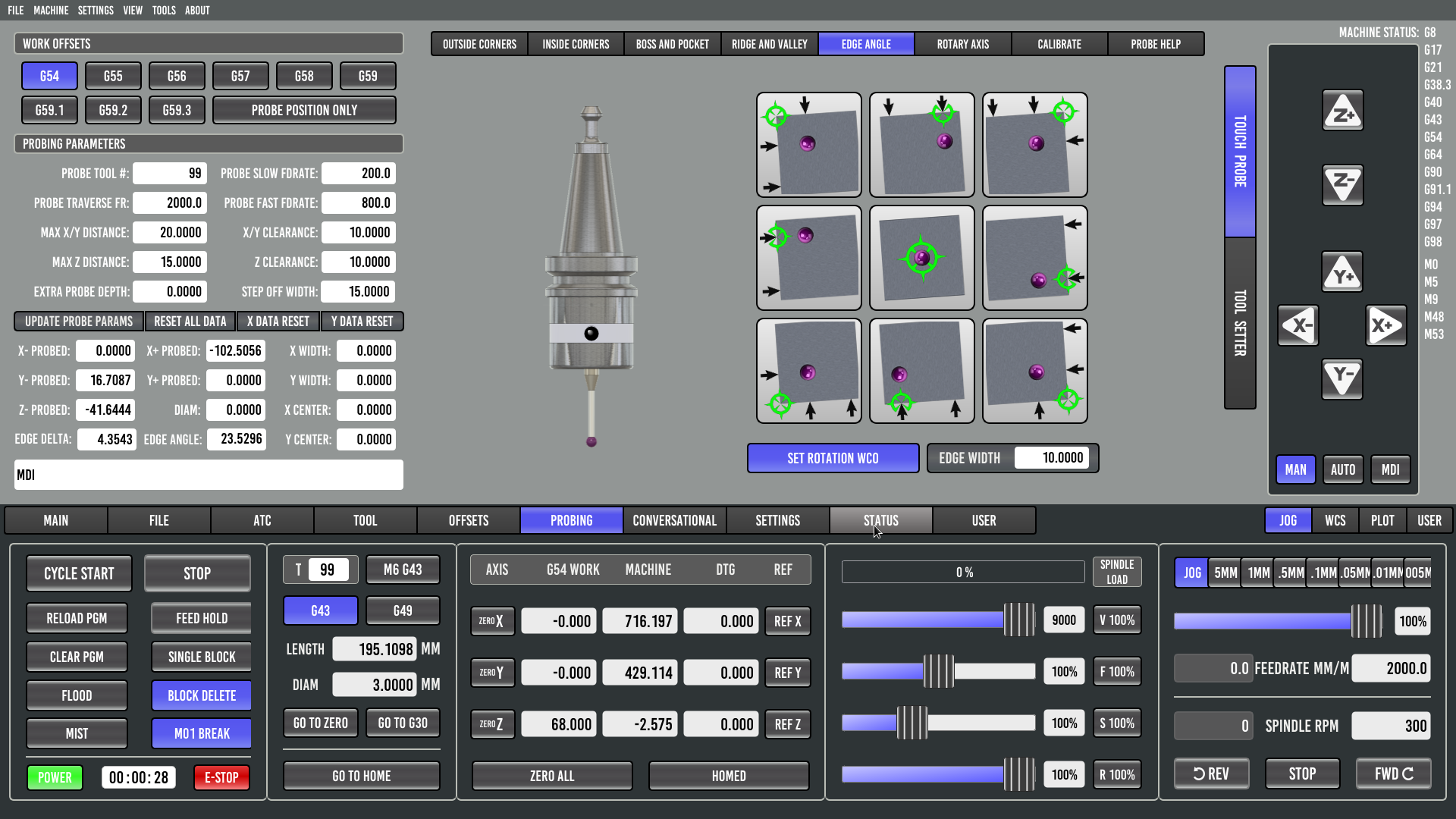

One additional question. After inserting the Tool manually, I am using the Angle function. It works so far and I get an angle reported. However, I assume that, when clicking "Set rotation WCO", that the rotation is saved in my WCO. However, looking at the Offsets Screen, it looks like it's still 0 (I assume that would be R?). Is this correct?

Did you save the file after changing it and restart lcnc after editing the file?
The "set wco rotation" button must be active when the probing routine is started.
