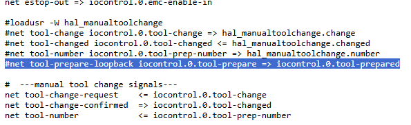

Okay, I think I didn't explain myself in my first post. When I said "install," I meant exactly that: using the SIM files on a machine already configured with Axis.
The problem I was having was with the PostGui file, and I already solved it. I had to comment out one more line.
Now it starts up perfectly, but I can't change tools; the Probe Basic tool changer window doesn't appear.
If I use the Axis tool changer window, it switches perfectly.

30 Mar 2025 06:13 #325314
by Lcvette
Replied by Lcvette on topic Probe basic lathe config
The following user(s) said Thank You: Ismacr63

30 Mar 2025 13:07 #325335
by Ismacr63
Replied by Ismacr63 on topic Probe basic lathe config
I had overlooked that line. Now everything is working.
I'd like to take this opportunity to ask you a question. I have a rotary encoder installed on the lathe for thread cutting, and my question is: is it necessary for Probe Basic to have a graphical rpm count in the interface for thread cutting? I'm not sure I explained myself correctly.
I still need to add the encoder and limit switches to the hal file.

30 Mar 2025 22:37 #325358
by Lcvette
It's not necessary, but if you have an encoder it's useful for verifying spindle rpm. The encoder signal does need to be connected in Hal for threading.
