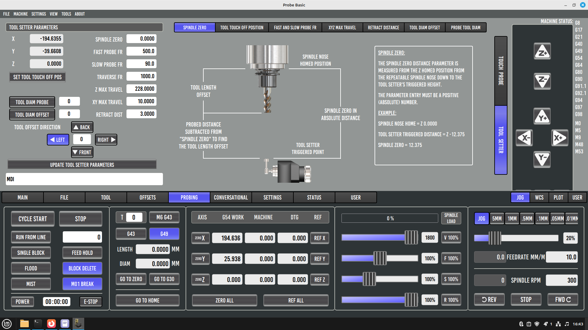

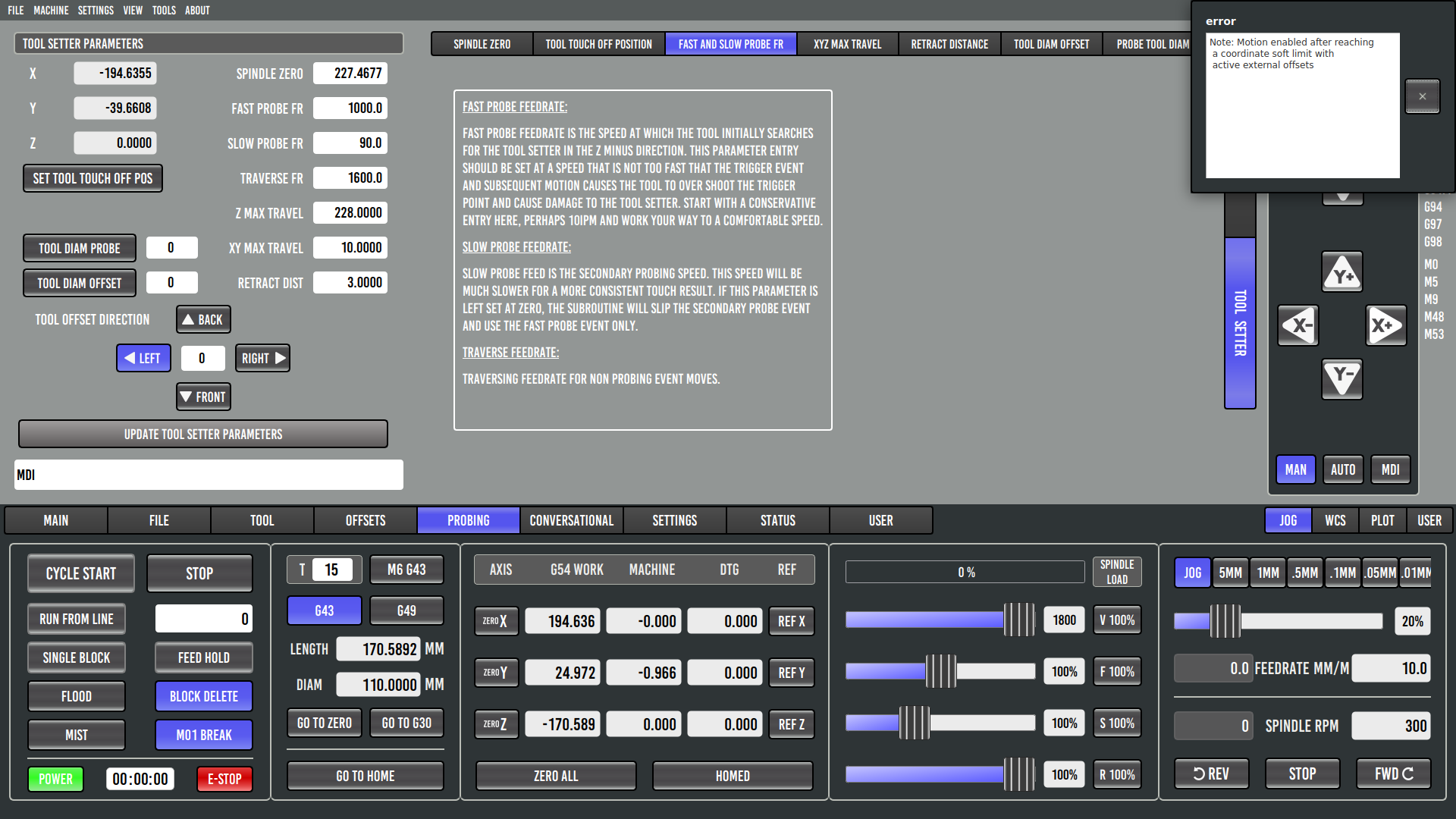

I'm having a problem with the tool setter configuration. I don't know if it's just me or if it's a known problem, although I haven't found anything similar on the forum.
When I modify a tool setter parameter, I click "update tool setter parameters" and it's saved. When I close Probe Basic and reopen it, the configuration changes to the previous one, and spidnle in the var file is reset to zero.
As a result, the milling machine has already crashed several times, until I realized that for some reason the configuration was out of order.
I'm also getting the error shown in one of the images when I turn Probe Basic on and off.
The error in the image shows the tool setter settings I entered, and the other image shows the settings that are set when I close and reopen Probe Basic.
I'm on the stable branch.

I updated Probe Basic and created a new configuration, but the problem isn't resolved.
I tried changing spindle zero in SIM, and it does retain the spindle zero value.

I updated everything again and created a new configuration.
Now the spindle zero value is saved in the var file, but in Probe Basic, after closing and reopening it, it shows the value 0, but the value I entered remains in the var file.
If I enter a value of 227.0000mm, for example, the value always remains in both the var file and the interface. However, if I enter 227.5456, it is saved in the var file, but then it appears as 0 in the interface.
