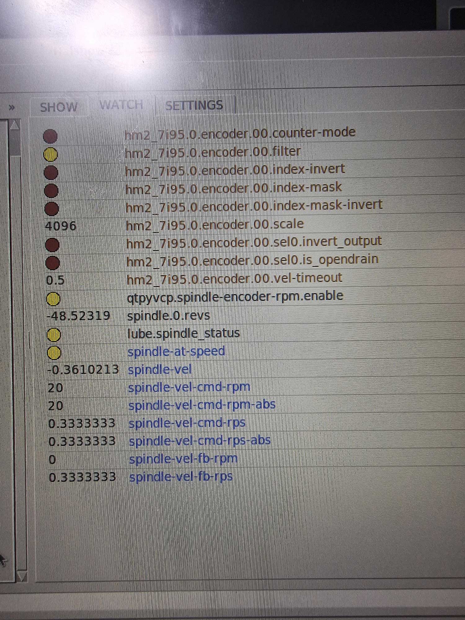

Hi guys, can't get spindle RPM to display, i have noticed a few different examples in the postgui.hal but non seem to work, i just get a -0 in my rpm display, I will attach my postgui.hal and my main.hal and a screenshot of halshow. Hopefully it's something very basic.thanks in advance

One way:
in the main hal file add:
net spindle-vel-rpm hm2_[MESA](BOARD).0.encoder.00.velocity-rpm
in the gui hal file delete:
net spindle.0.revs => qtpyvcp.spindle-encoder-rpm.in
and add:
net spindle-vel-rpm => qtpyvcp.spindle-encoder-rpm.in
and add:

amazing it works thank you, just need to change it so its not a minus sign before the reading
