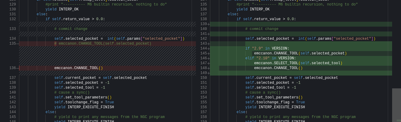

What version of linuxcnc are you running. We noticed the python broke on atc between 2.9.4 and 2.10 master.
If you're running master, check the updated python file from the latest develop version of probe basic. Run a meld file comparison to see if the latest edit is in your current python file.

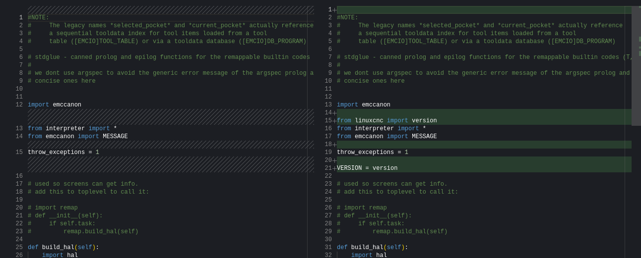

correct, here was the required change, we made a either or fix in the file. but if you are on 2,9,4, unless what ever broke things in 2.10 was also added to your specific branch version of 2.9.4 for what ever reason. either way, i would grab the latest python stdglue file and pop it in your config folder just to be safe.

I applied the stdglue change, no change. From what I can tell, the controller/Carousel module is losing count of the current pocket, mostly when running store tool in carousel. Is the logic built into the stglude to reflect the current pocket from probe basic back to the controller? Or is that something that the end user has to do when configuring it to their machine?
