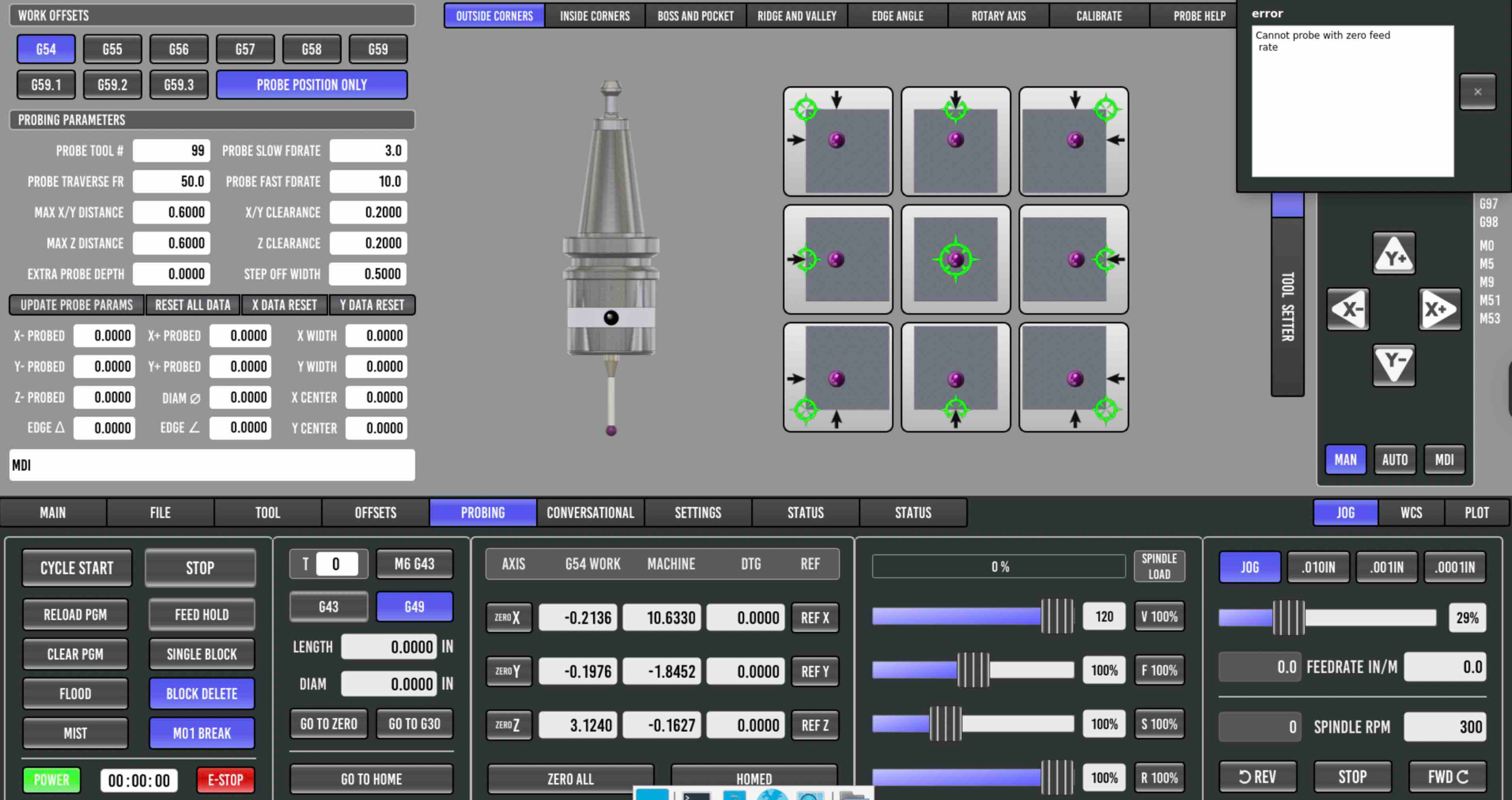

Most of the time, when I try to probe, I get a debug message saying the feed rate (most often) or tool is not set (says to load tool 0 when its set to 99). Which they are set (see attached screenshot). If I "change" them to the same value, it works fine. I am using the latest update (from a few weeks ago). Also, note that the parameters are saved correctly in the .var file. Not sure what else to check.

You're either missing parameters in your var file or you need to update for the latest fix which was done shortly after the latest push was released due to a format error. If you verify your car has the correct car numbers listed so parameters can be saved persistently t then it's an update you need to run to resolve.

Your picture above, you have to 99 listed as probe tool. But no tool loaded in software. Shows 0 as being the loaded tool.

The loaded tool impacts the feed rate?
It will prompt later in the flow to load the correct tool. Based on the settings.
Why does it say 0 feed rate?
Lastly, how do I tell what version of PB I have installed?
