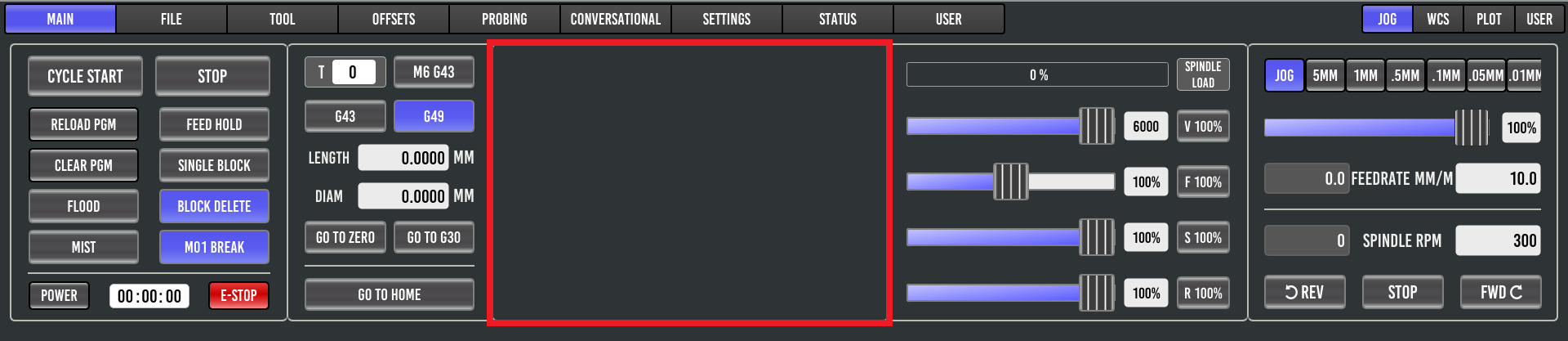

Dear community,After I performed system (Debian 12) updates, the axes are missing in the GUI
[code][code]sudo apt update
sudo apt uprade
[/code][/code]
Does anyone have any idea what could be causing this?

Even with clean and autoremove, the axes are missing in the GUI

I've suspended a new system. Before the computer goes offline and goes into the basement, I wanted to bring everything up to date again.
The repair was unsuccessful.

Also, anytime you update if there is something missing in probe basic using your machine config on program open, check the probe basic simulation from within the linuxcnc sims. It will always have any updated requirements performed. If the sim opens and appears normal, then it's a safe bet that  it's your machine configuration requiring new updates. We put information right on the status page that is updated with new releases with a link to any requirements due to upgrades in probe basic.  Always start there.

A classic case of RTFM... Thanks Lcvette, I'll check it out tonight

Hello , i've got the same Problem but the manual doesn't help me.
Have you solved this problem?

Docs have the required settings and files that are needed, read through the notes section and make sure you have the folders required in your config folder and the correct in settings.

Thank you,
after i have had read the manual i could solve the problem.
