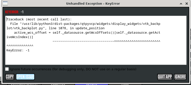

Hey guys!
My linuxcnc / probebasic started to show a weird behaviour today.
After I start the system and home the machine, I get a popup saying "KeyError" _everytime_ when I jog any of the axes.
I can ignore that message, but it comes back everyime I jog again (no matter if via keyboard, softkey or pendant).
BUT - what I found out... as soon as I zero one of the axes (or all three), the error is gone.
I have not changed anything in my (software) config the last week, BUT I have modified my x axis yesterday and therefore moved the limitswitch a bit.
Can this somehow be related? The popup says somewthing with "...active.WCSoffset..."... maybe some cached value doesnt fit anymore after I moved that switch?
Thx in advance!

Replied by andypugh on topic "KeyError" suddenly appears after moving a limitswitch
"Key Error" means that the system is looking in the object returned by getWcsOffsets() call for an item that doesn't exist.
It looks like, for whatever reason, the getActiveWcsIndex() call is returning -1. There isn't a -1-th WCS, so it returns an error message.
This looks like qtPyVcp isn't handling the case when the apparent WCs is zero properly.
github.com/kcjengr/qtpyvcp/blob/main/src...c_datasource.py#L194

04 Aug 2025 20:28 #332860
by SebastianM
Replied by SebastianM on topic "KeyError" suddenly appears after moving a limitswitch
Alright, understood.
Today I spent some time with my cnc. I setup a new machine in LinuxCNC, and now I have two setups.. one is "good", and the other one shows this issue.
What I found out - when I startup the "bad" machine and open the "probing" tab, none of the work offsets at the top is selected.
When I start the "good" machine, G54 always is preselected.
No idea if this makes sense or helps, but it fits to the error message imho...

04 Aug 2025 21:51 #332863
by Lcvette
Replied by Lcvette on topic "KeyError" suddenly appears after moving a limitswitch
ok, so then in your other config in the ini, add G54 to the start line and it should resolve for the time being. I will investigate the scenario here with it removed from the startup and see if i can reproduce, if so i will look at hardcoding a default work offset for startup to avoid the error in future releases. great job identifying the difference!
