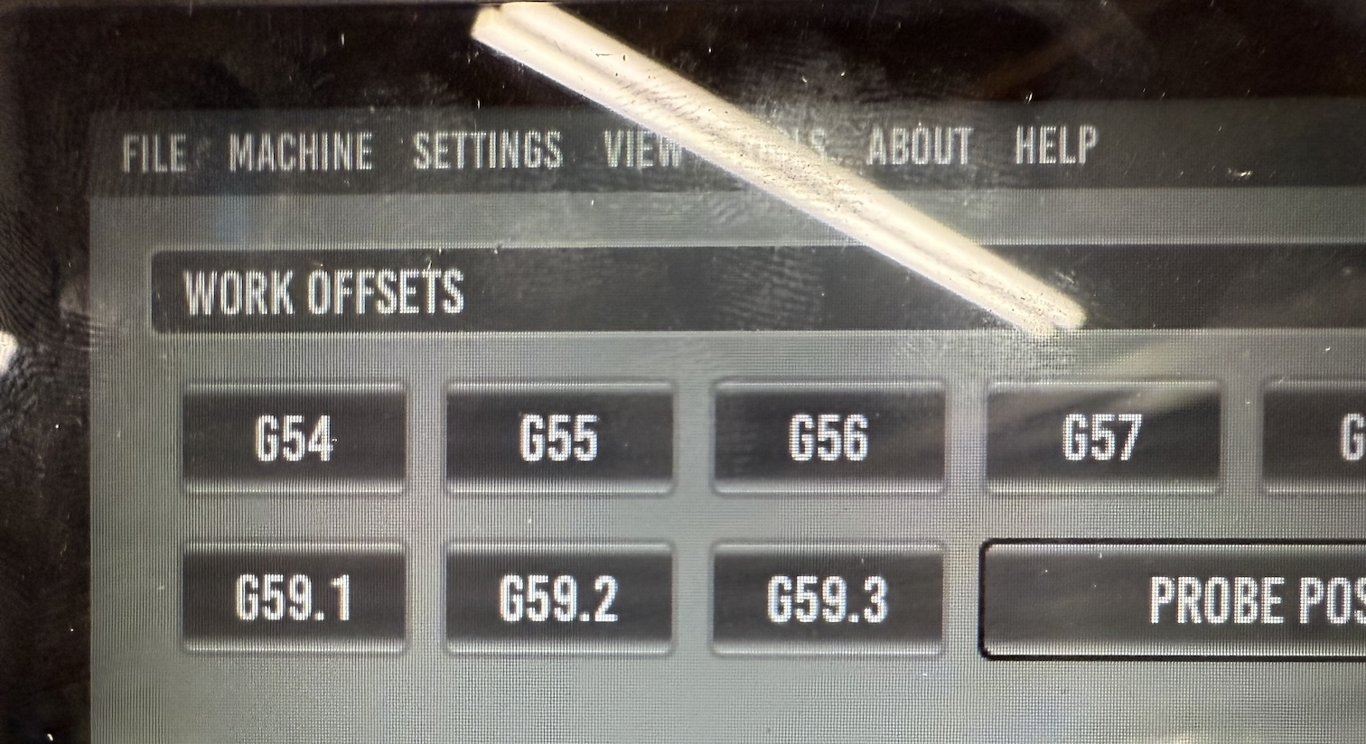

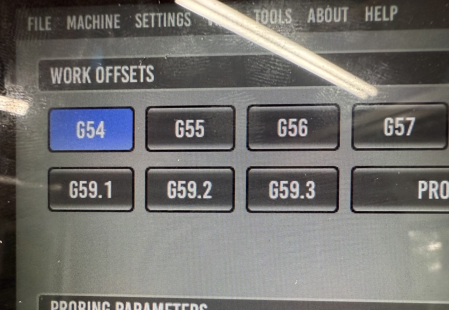

Today I spent some time with my cnc. I setup a new machine in LinuxCNC, and now I have two setups.. one is "good", and the other one shows this issue.
What I found out - when I startup the "bad" machine and open the "probing" tab, none of the work offsets at the top is selected.
When I start the "good" machine, G54 always is preselected.
No idea if this makes sense or helps, but it fits to the error message imho...
04 Aug 2025 21:51 #332863 by Lcvette
ok, so then in your other config in the ini, add G54 to the start line and it should resolve for the time being. I will investigate the scenario here with it removed from the startup and see if i can reproduce, if so i will look at hardcoding a default work offset for startup to avoid the error in future releases. great job identifying the difference!
