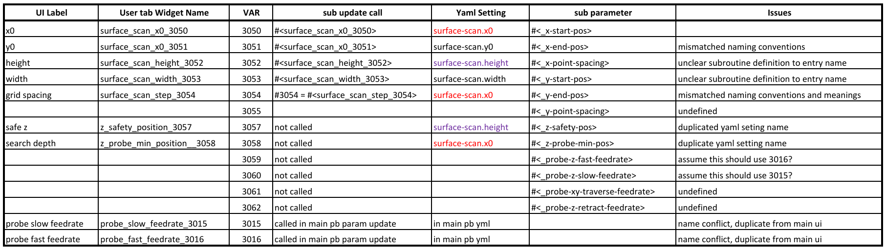

i found some really odd namings in the ui for the widgets, it is very confusing and appears to be unfinished or a the very least very poorly internally connected. i'm not sure where some of the parameters are coming from or if they were intended to be hard coded only in the var file or not. I don't think this is actually a finished project from the looks of it, at least not from the link you posted above. you may want to try contacting zmrdko.
from my scan through the ui, subroutines etc, things do not match up and widget names are duplicated as if copied and pasted but not correctly named so it's hard to follow the parsing flow correctly.
there is also no custom_config.yml setup instructions for the ui widgets to be stored in and saved and loaded on startup which means everytime you startup probe basic, those variables in the ui will be dumped and set to placeholder text (0.0000) which will be unsynchronized with the persistent var file data.
these are things that can be resolved in the upcoming release as i created a new var line edit widget that will not rely on subs to store and load variable from the var file.
some of the numbered parameters you listed above are linuxcnc params:
linuxcnc.org/docs/stable/html/gcode/over...:numbered-parameters
any params used in probe basic or any other add on would be between 3-5000 as these are user configurable parameters. anytime you see one 5001 or higher it will be a dedicated parameter used in linuxcnc.
I would say that this project is still a work in progress from my look into it.here is my mapping of everything, you could probably fix it and ask the developer for a pull request if you wanted, that would be the course i took,but as it stands i don't think you will be able to get it working as is.

Thanks for taking the time to have a look, and for confirming my suspicion that the surfacemap code might not be complete.
Is there any prospect of an official probe_basic surface grid probing and z-compensation tab? Perhaps using scottalford75's z-compensation code via external offsets:
github.com/scottalford75/LinuxCNC-3D-Pri.../master/compensation
(I think this feature may already be included in QTDragon, although with compensation via g-code ripper rather than external offsets).
Sorry for possibly adding to your already no doubt long to-do list!

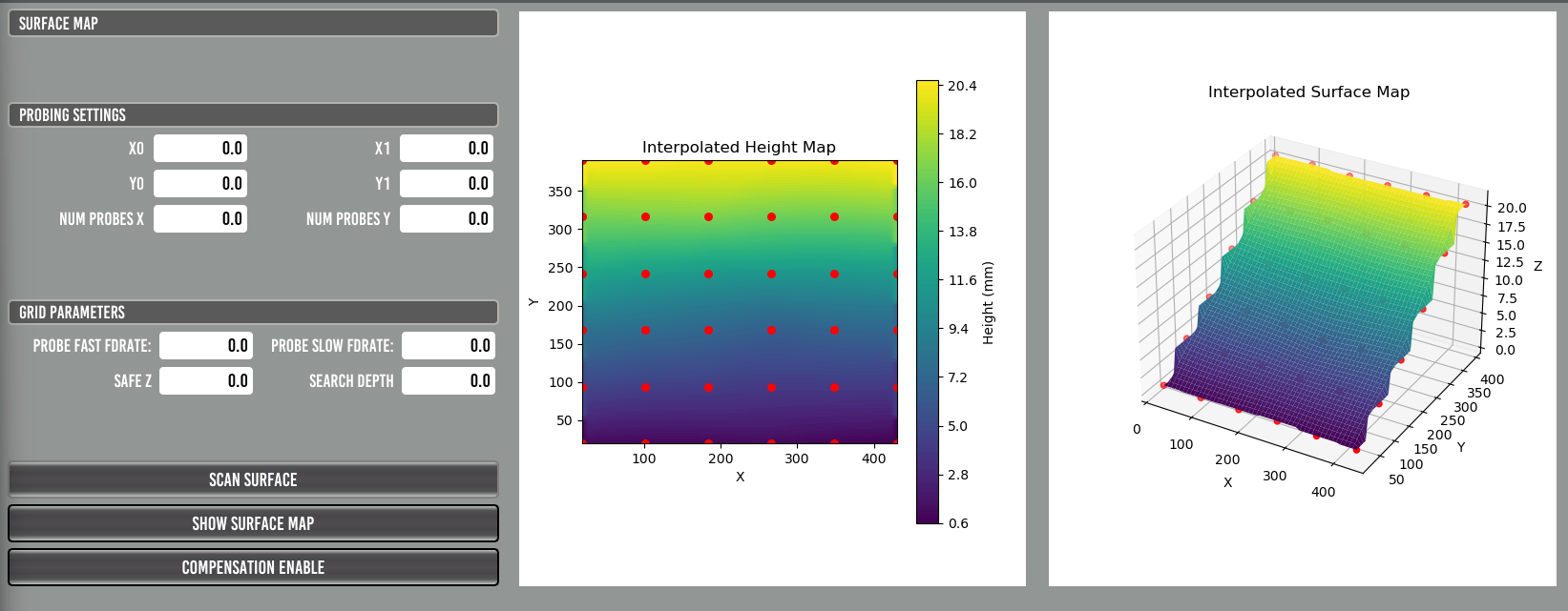

I saw this thread and went down a similar road trying to get a user tab set up for surface compensation. The linked repo was indeed incomplete, but I was able to use it as a starting point and get this working with some trial, error, and LLM assistance.
Hopefully someone will find this useful: github.com/Blair-Johnson/surfacemap_usertab

Replied by Sandro on topic Surfacemap Z compensation with Probe Basic
Really nice work thank you.
I’ve modified the interface so that the scanned surface can be visualized with a button press. The next step is to make the probing settings persistent across LinuxCNC sessions. These settings are stored in the .var file, but I’m not sure how to load them at startup and update the Qt widgets accordingly.

Here is a version, which creates a surfacemap.yml so the parameters persist throughout sessions. The variables like probe fast feed rate are still independent from the standard PB probing parameters. Maybe this can be aligned in a future version of this interface.
