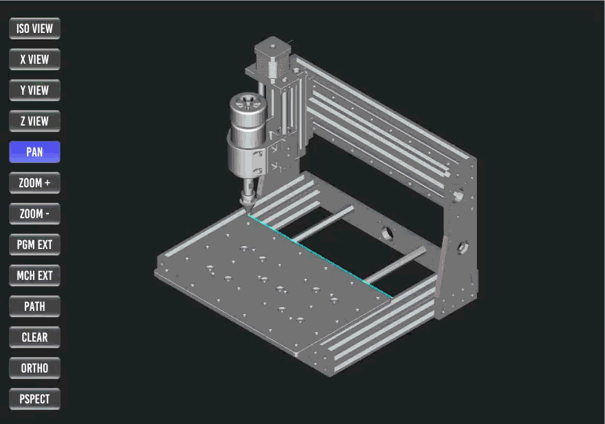

27 Feb 2026 19:33 #343620
by Lcvette
Replied by Lcvette on topic QTPYVCP+VISMACH+LINUXCNC ROLLED INTO ONE?
you can adjust the vtk code to offer dynamic plot functionality. you need to add in code to correctly follow the tool and define which components of the machine remain stationary and which have motion and assign the plot constraints to match.
this has been a planned upgrade for a while now but we have a bunch going on with the move to pyside6 qt6 so this is kinda down on priority list as most folks don't both with machine simulation so its a minority "want" at the moment.
if you want to dig into the vtk display and see if you can sort some things out that would be fantastic. i have a branch already that has some good work in it where i was working on multi axis which is pretty brutal when it takes so long to test each change. I will see if i can catch up that old branch and leave the sections i was working with notated and commented out as a starting point but it will likely be next week before i can even do it since i have a pyside system currently setup as dev.

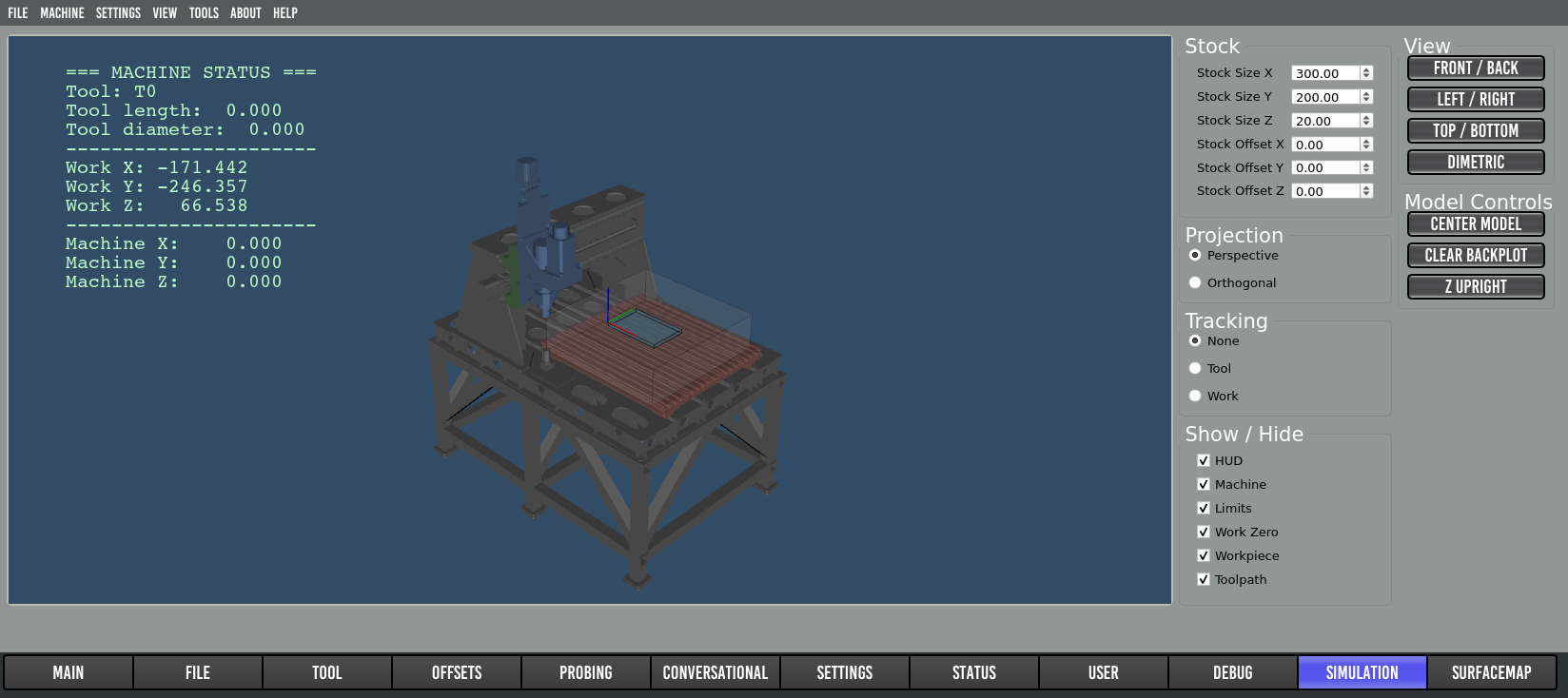

- Posts: 4789
- Thank you received: 2157
28 Feb 2026 07:40 #343636
Replied by Aciera on topic QTPYVCP+VISMACH+LINUXCNC ROLLED INTO ONE?
For an example on how to implement toolpath plotting in work coordinates using vtk see:
github.com/Sigma1912/vtk-vismach
'Capture()' embeds an invisible actor in the model that can then be used to track the transformation matrices for the tooltip and the work which can then be used to plot the toolpath.

28 Feb 2026 07:51 #343637
Capture class:
github.com/Sigma1912/vtk-vismach/blob/main/vtk_vismach.py#L832
Plotter class:
github.com/Sigma1912/vtk-vismach/blob/main/vtk_vismach.py#L742
tool->work transformation matrix is calculated in the update() method:
github.com/Sigma1912/vtk-vismach/blob/main/vtk_vismach.py#L796
Works for me.
Plotter class:
Works for me.
- Sandro
- Posts: 77
- Thank you received: 37
28 Feb 2026 09:09 - 28 Feb 2026 09:22 #343642
by Sandro
Replied by Sandro on topic QTPYVCP+VISMACH+LINUXCNC ROLLED INTO ONE?
Based on Acieras vtk vismach integration I've made a usertab for probe basic. The files are a drop in simulation config which should get you going. Credit for the code goes to Aciera.
github.com/bildobodo/probe_basic_vtk_sim_gcode

- Lcvette
- Posts: 1635
- Thank you received: 763
28 Feb 2026 14:01 #343654
by Lcvette
@Aciera you should come play with the primary vtk display for qtpyvcp!! looks like you have sorted a good bit out, would love to have it native without needing a secondary add-in for simulation.

- amanker
- Posts: 119
18 Mar 2026 05:39 #344450
by amanker
Replied by amanker on topic QTPYVCP+VISMACH+LINUXCNC ROLLED INTO ONE?
I have added 4th axis rotary and 5th axis tilting head, bascially XYZAB configuration. In vismach it moves machine parts (rotary and tilting head) as i move A/B axis. But tool remains at same loaction, it moves on xyz only.
