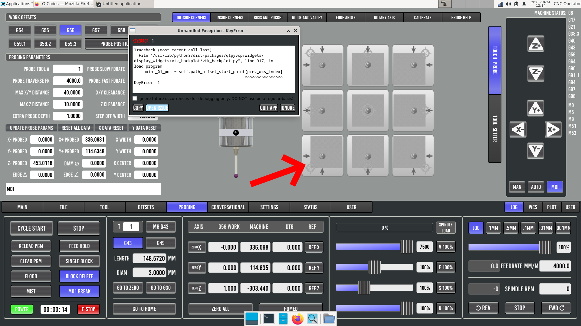

Thanks for looking into this issue.
I opened the attached file I ran the following commands without encountering any issues:
G10 L2 P1 X0 Y0 Z0
G10 L2 P2 X0 Y0 Z0
G10 L2 P3 X0 Y0 Z0
However as soon as I set the value of G56 using the probing function highlighted below the error appears when the probing has finished.

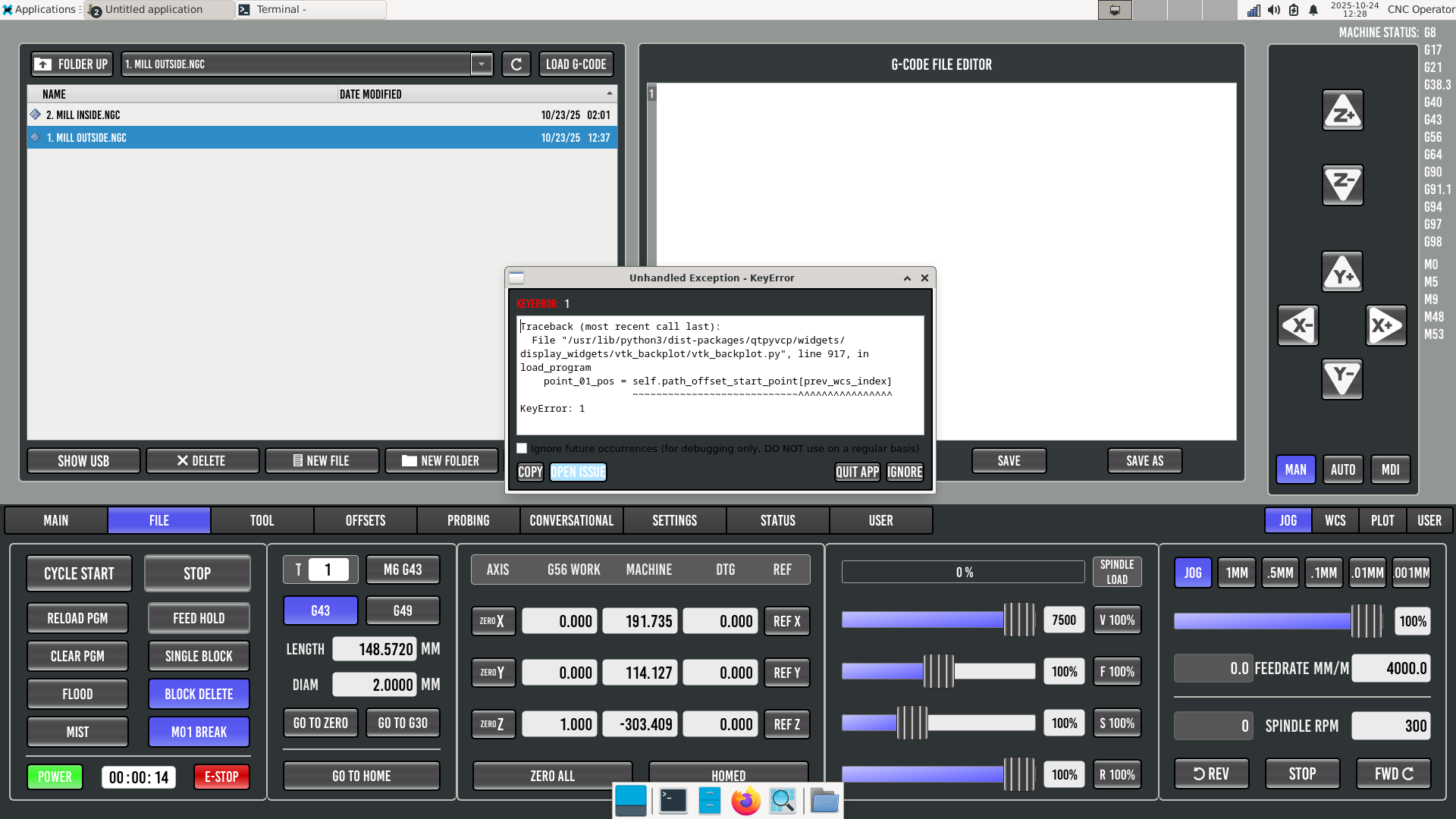

This seems to be related some type of state that gets set during the probing of G56. Because if I probe G56 with no file open and then open the attached file it triggers the error immediately without any further input required.
G10 L2 P1 X0 Y0 Z0
G10 L2 P2 X0 Y0 Z0
G10 L2 P3 X0 Y0 Z0

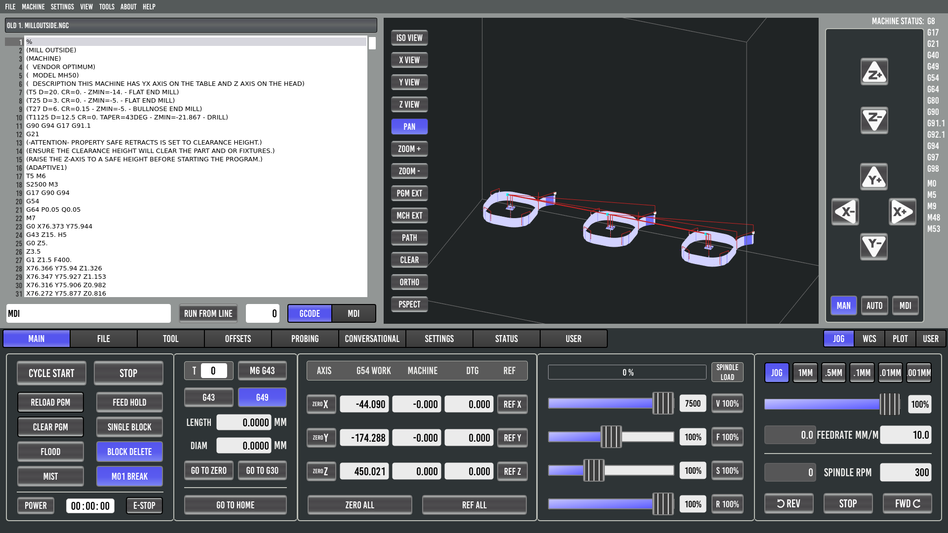

Here are the steps I did to produce the following screenshots.
I started by setting all the G54, G55 and G56 offsets to all zeros:
G10 L2 P1 X0 Y0 Z0
G10 L2 P2 X0 Y0 Z0
G10 L2 P3 X0 Y0 Z0

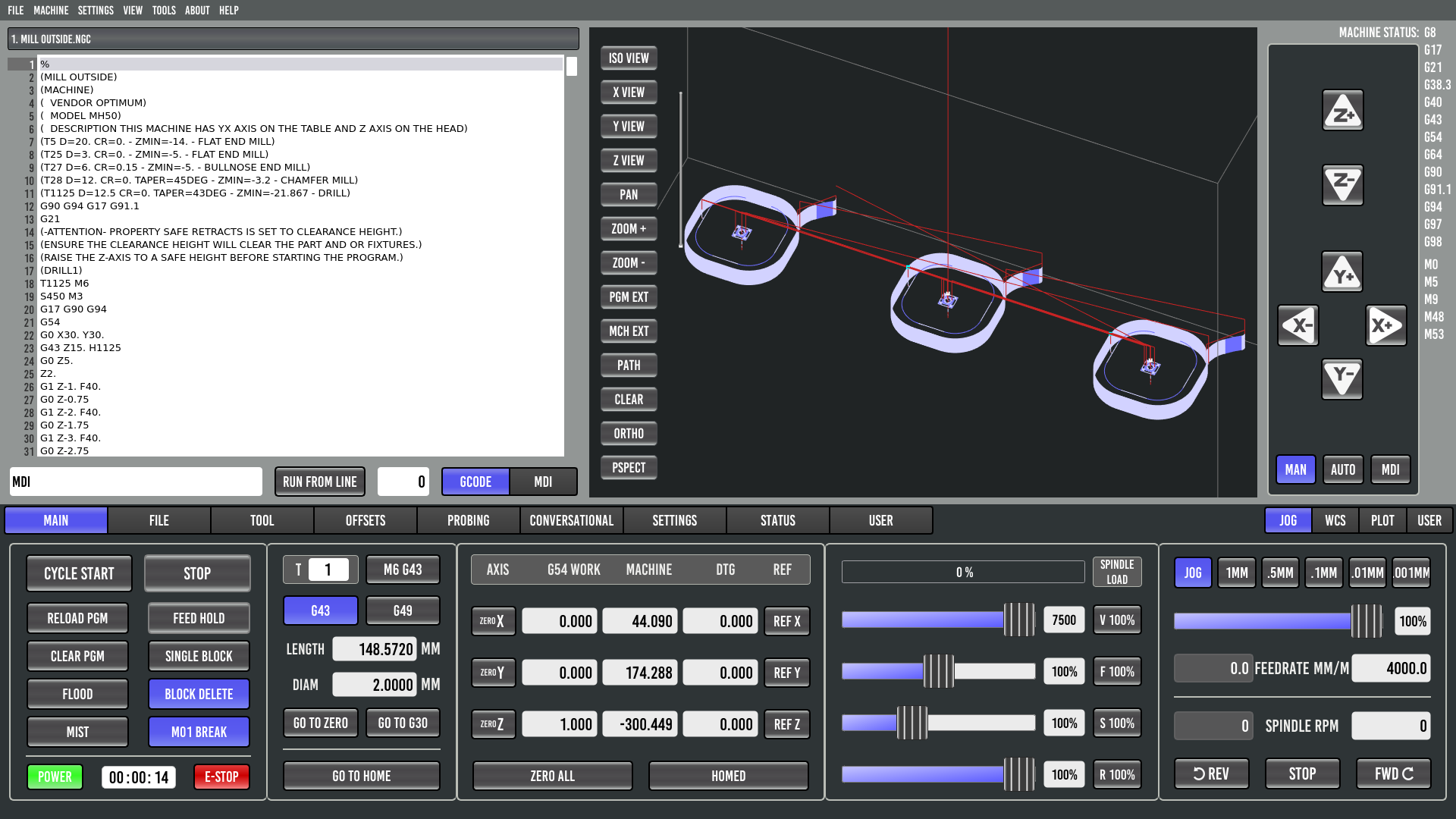

I then loaded the file attached to my first post and probed all the three parts going from right to left (starting with G56, then G55 and finally G54). The probing worked and there was no crash but the plot show some strange moves.
Opening the same file again without doing anything else produced the following plot instead.
The plot above looks better but I think it's not fully correct as it should start with the left most part not center one.

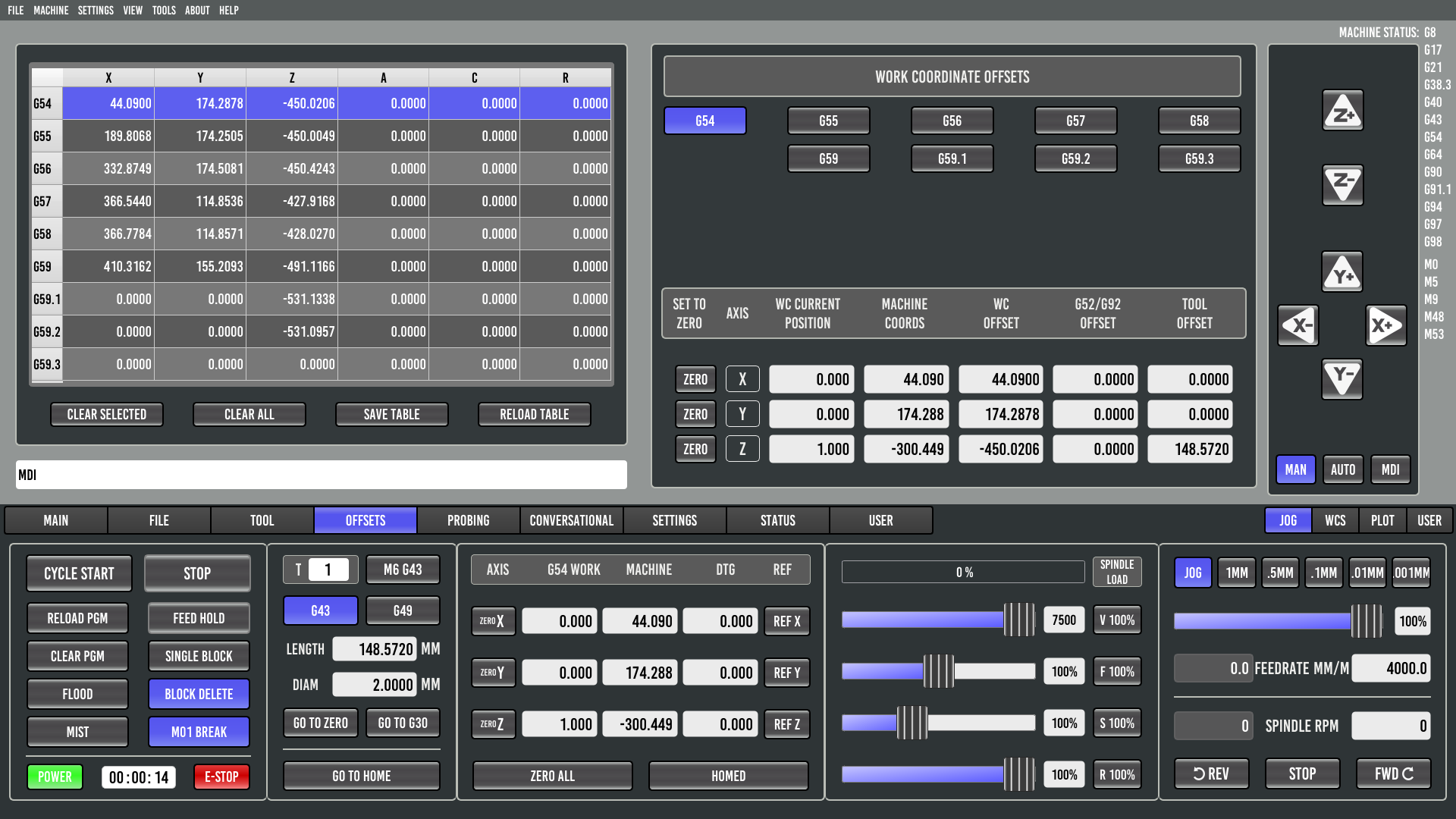

Here are the offset values for G54, G55 and G56 used for the two plots above.
They are clearly making progress on this issue because with the patch the crash is gone. However I noticed a slight side effect with the plot not drawing all the moves correctly.
G10 L2 P1 X0 Y0 Z0
G10 L2 P2 X0 Y0 Z0
G10 L2 P3 X0 Y0 Z0
