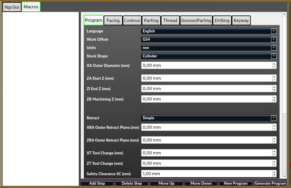

Hi all,
I want to share an experimental QtVCP macro I am currently working on:
LatheEasyStep.
It is embedded into the QtDragon lathe panel and aims to simplify
lathe programming by replacing manual G-code writing with a structured,
step-by-step workflow (facing, contouring, parting, threading, drilling,
keyways, etc.).
Each operation is configured in its own tab with tool, spindle, feed,
coolant and geometry parameters. The macro then generates a complete
lathe program, including comments and basic safety moves.
Important notes:
- This project is NOT finished.
- The G-code generation still needs restructuring and improvement.
- I built the first working version with the help of AI, then refined it
manually. I am very aware that this often leads to suboptimal structure,
which is exactly why I am asking for feedback.
What I am especially looking for:
- Suggestions for a cleaner G-code generation architecture
- Common LinuxCNC lathe pitfalls I should explicitly handle
- Ideas for improving safety, validation, and workflow
- General QtVCP / QtDragon best practices
The project is GPL licensed and available here:
github.com/peter-pan08/LatheEasyStep
Critical feedback is explicitly welcome. I am more interested in doing it
right than doing it quickly.
Thanks in advance!

Replied by cmorley on topic LatheEasyStep – experimental QtVCP macro for step-by-step lathe programming
This should be moved to the Qtvcp section.
Looks promising! Keep is updated! If you get stumped with the programming i can try to help.
