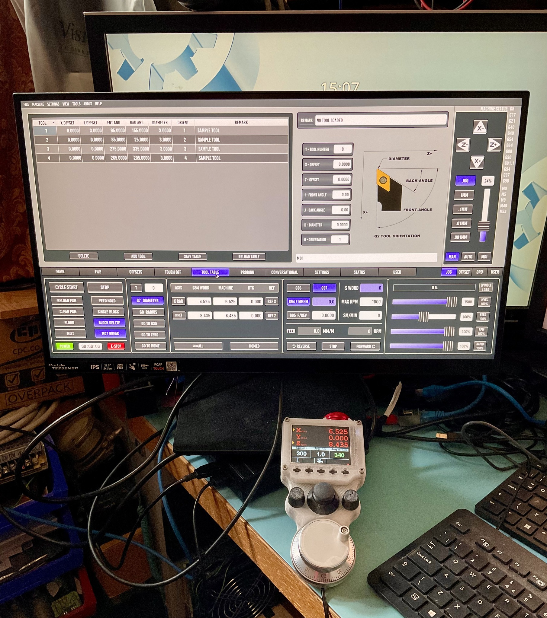

08 Apr 2026 14:06 #345322
by susan-parker
Replied by susan-parker on topic 30 Second timeout before opening and E-Stop button not clicking...
The following user(s) said Thank You: tommylight, Clive S, Lcvette

14 Apr 2026 01:13 #345512
by Lcvette
Replied by Lcvette on topic 30 Second timeout before opening and E-Stop button not clicking...
You can set the overrides so you can go both ways while running, the settings are in the ini file, check the Sims for reference.
