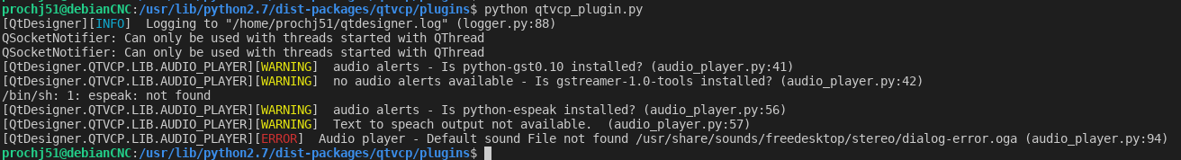

So I tried to run qtvcp_plugin.py independently and this is what I got:
the problem in my case is that the folder /freedesktop/ does not exist in /share/.
The another thing. I am sure that I have python-espeak, since I can import it in python, but I noticed in code that you run some
subprocess with espeak as it was in command line. I tried to type in bash and command not found, so apparently
it did not add itself to the PATH during the installation. I do not know if it should though.
Thank you for the advice

espeak does not matter at all, as you said its optional (and probably just a novelty)
The audio player error doesn't matter - audio sounds just won't work
Though I'll have to find out the proper file paths..
If you run designer from the terminal what doe it say (in the terminal)
Chris

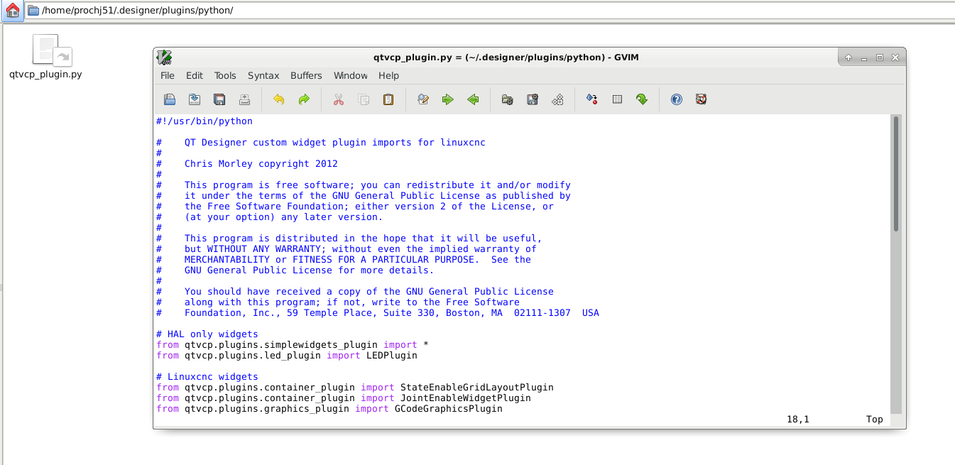

- prochj51
- Posts: 90
09 Feb 2020 07:01 #156836
by prochj51
Replied by prochj51 on topic Qtvcp is missing on linuxcnc environment
- Posts: 7368
- Thank you received: 2181
09 Feb 2020 07:17 #156839
Replied by cmorley on topic Qtvcp is missing on linuxcnc environment
looks like your link in /designer/python/plugin is called qtvcp_plugin
try qtvcp_plugin.py
My test shows the .py ending is required
Chris
try qtvcp_plugin.py
Chris

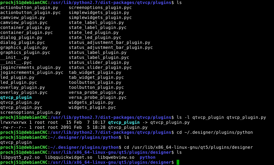

- prochj51
- Posts: 90
09 Feb 2020 09:42 #156853
by prochj51
- Posts: 7368
09 Feb 2020 10:21 #156856
well it seems to work for me here in a RIP version.
I would suggest try putting the link in :
/usr/lib/x86_64-linux-gnu/qt5/plugins/designer/python
and see if that works
