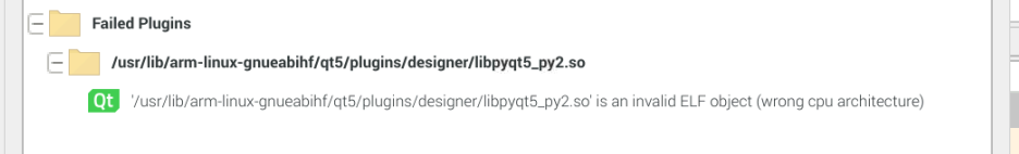

23 Apr 2022 17:47 - 23 Apr 2022 17:48 #241009 by ajsinfotech
Replied by ajsinfotech on topic Installing QtVCP
Hi phillc54,
I am working on a RPi4.
I manage to build and run Qt5/PyQt5 from source but I get the following:
Where can I find the libpyqt5_py2.so pluging binary for RPi4?
If not, where can a find the source and build instructions to build a brand new libpyqt5_py2.so plugin for RPi4?
I think it is a platform conflict, so it seems making a rebuild for RPi could be work.
Thanks!

23 Apr 2022 23:43 #241039 by phillc54
Replied by phillc54 on topic Installing QtVCP
I seem to recall that there was an issue with the python-opengl module that prevents QtVCP being used on a Pi. I think it was built using OpenGL ES and QtVCP requires OpenGL Desktop. I have no clue as to whether this has changed recently.
