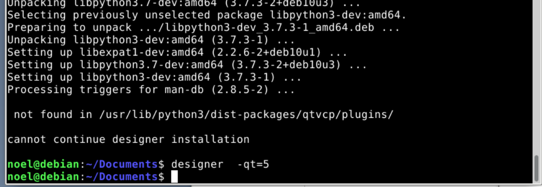

07 Sep 2021 18:51 - 07 Sep 2021 20:15 #219869
by Roguish
Replied by Roguish on topic Installing QtVCP
Install script not working quite right.........
OK. created a VM with the downloaded 2.8 .iso. no problem there.
Copied and ran the '2.8 branch instructions' and ran the script. thanks for the script. very handy.
But, errored. see the image.
Looked for the qtvcp_plugins.py file. Found it in the usr/lib/python2.7/dist-packages/qtvpc directory.
Made a link to that in the .designer/plugins/python directory (had to make both the plugins and python directories.)
QTdesigner starts, but no linuxcnc widgets......
Where do I go from here?????
checked. there is no other qtvcp_plugins.py. not in python3, or python3.7...........
where can it be?
where can it be?
Last edit: 07 Sep 2021 20:15 by Roguish.

07 Sep 2021 23:26 - 08 Sep 2021 02:06 #219894
by phillc54
Replied by phillc54 on topic Installing QtVCP
Last edit: 08 Sep 2021 02:06 by phillc54.
- Posts: 7368
- Thank you received: 2181
08 Sep 2021 02:03 #219903
Replied by cmorley on topic Installing QtVCP
2.8 - you use python 2
master you use python 3
I you're going to use 2.8 then you can use your lathe macros just as before.

08 Sep 2021 20:52 #220003
by Roguish
well, again thanks.
I switched to 2.9pre on the buildbot and used that script. changed the pointer as required, and it worked. cool.
but I can't get linuxcnc to use my modified .ui file.
rather than clutter up this I'll post a new topic.

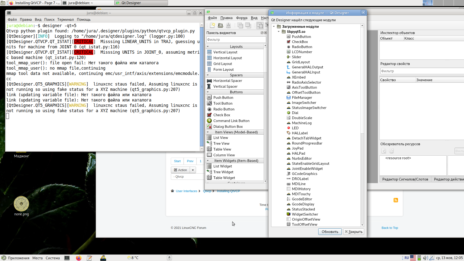

- hottabich
- Posts: 574
- Thank you received: 96
13 Oct 2021 09:18 #223013
by hottabich
Replied by hottabich on topic Installing QtVCP
LINUXCNC - 2.9.0-pre0-4760-gc4345283f usr/lib/python3/dist-packages/qtvcp/designer/install_script. Start designer. What's wrong here?
