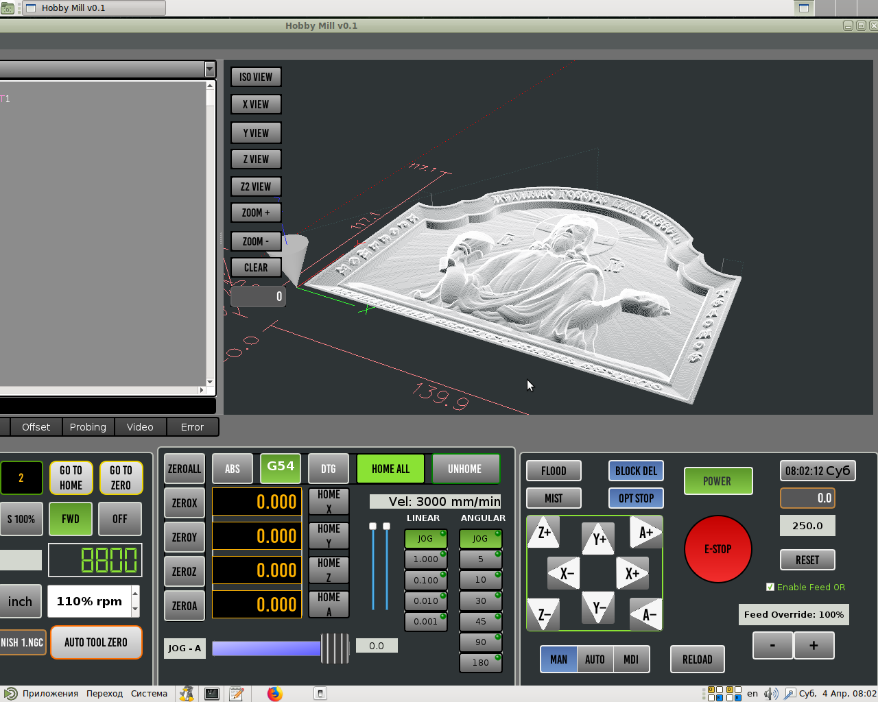

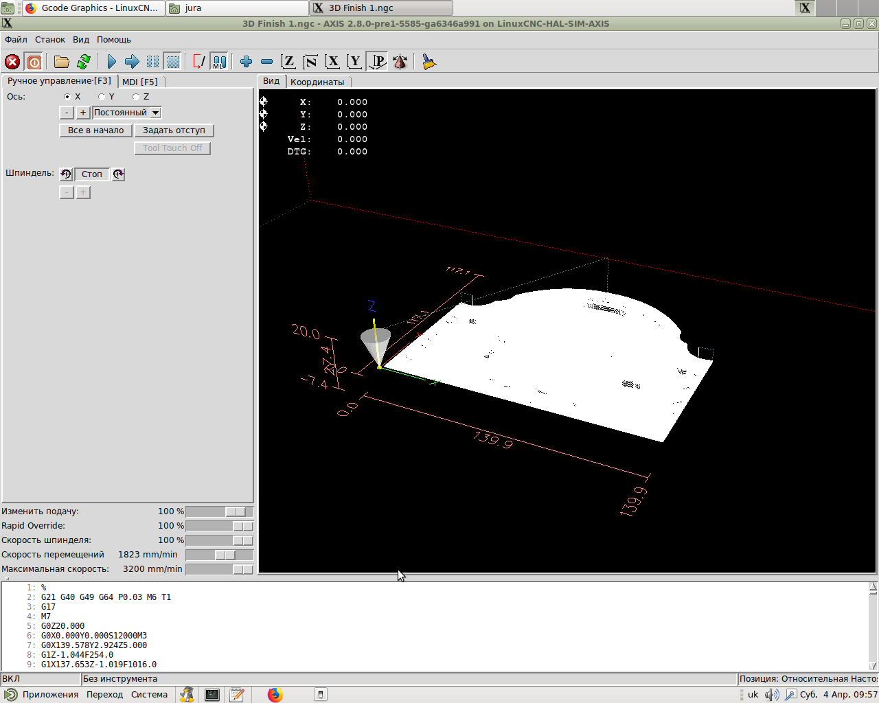

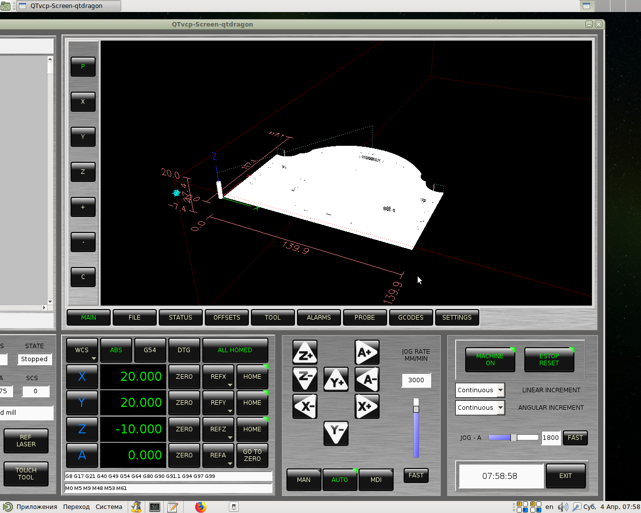

Hello! Please tell me how to increase the resolution in Gcode Graphics or integrate

I don't know what the problem Gcode graphics. Could you post a sample prorgram that shows the problem so i can test? Even a partial (if you are worried about giving away a gcode program)
As far as adding qtpyvcp's backplot - that would be nice it uses different technology.
Unfortunately it requires newer libraries then some of our distributions supply.
I will look into seeing if we could suport both technologies in the future.

Thank you for attention! In AXIS, visualization is like in Qtvcp. I just can't go from MACH3 to
Linuxcnc. Qtvcp has poor visualization, and jogIncremental is not working properly in Qtpyvcp.

this are very tight lines if thel ines are more spaced as of the cutter it looks like rougher
but this is normal behavior it does not show the Part only the millinglines
if yoiu zoom in it also gets rougher to thel ines
use CAMOTICS to show the outcome of g-code
and visual in Blender

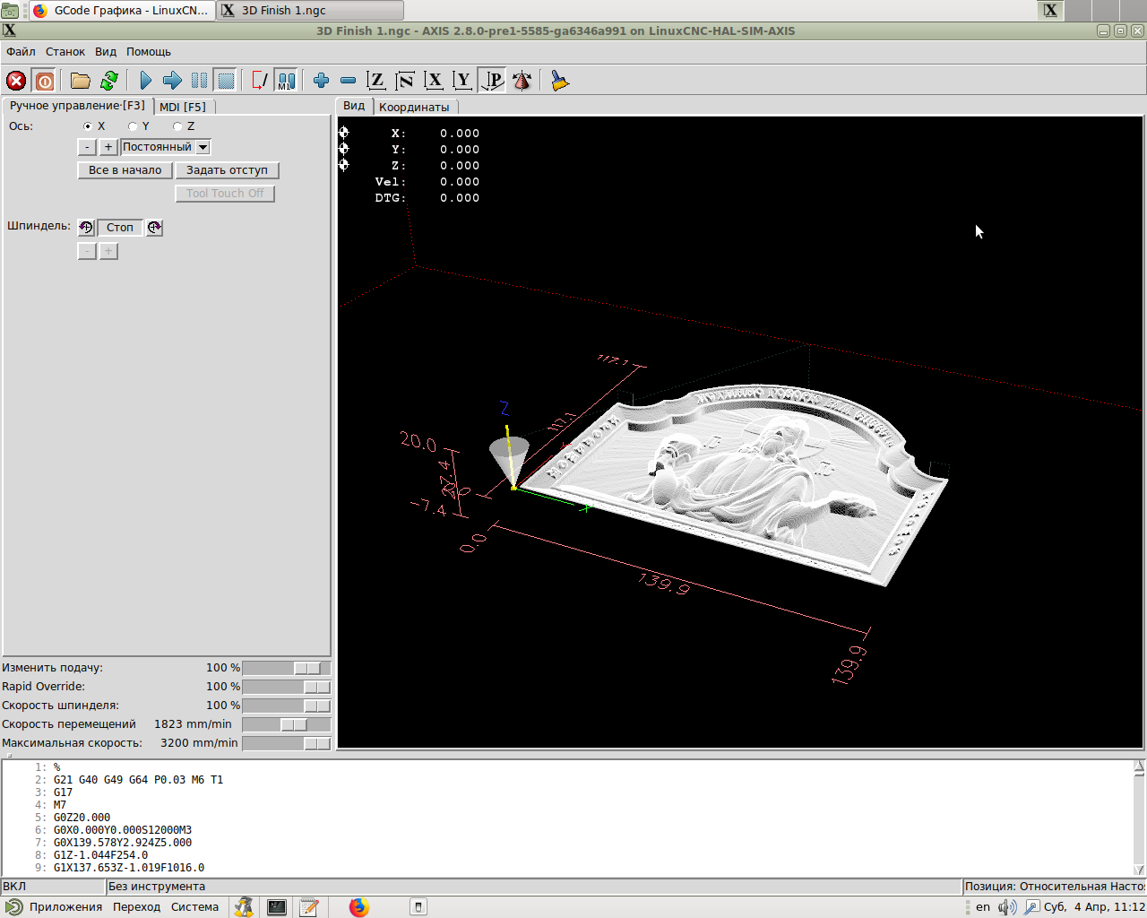

Replied by cmorley on topic Gcode Graphics
In AXIS try selecting alpha_blend in the 'View' drop down list.
It made quite a difference.
If that's an improvement I can easily add that to qtvcp.
Chris

Super! Can this be added to Qtvcp?

yes the code is there - it just needs to be turned on.
You did a custom screen for qtdragin didn't you?
add:
self.w.gcodegraphics.program_alpha = True
to init_widgets(self); function
I'll see about making it easier in the future.

Thank you so much! The picture is beautiful, but it cannot be moved in the window.
The file is being reloaded. In Qtpyvcp, I freely move the picture.
