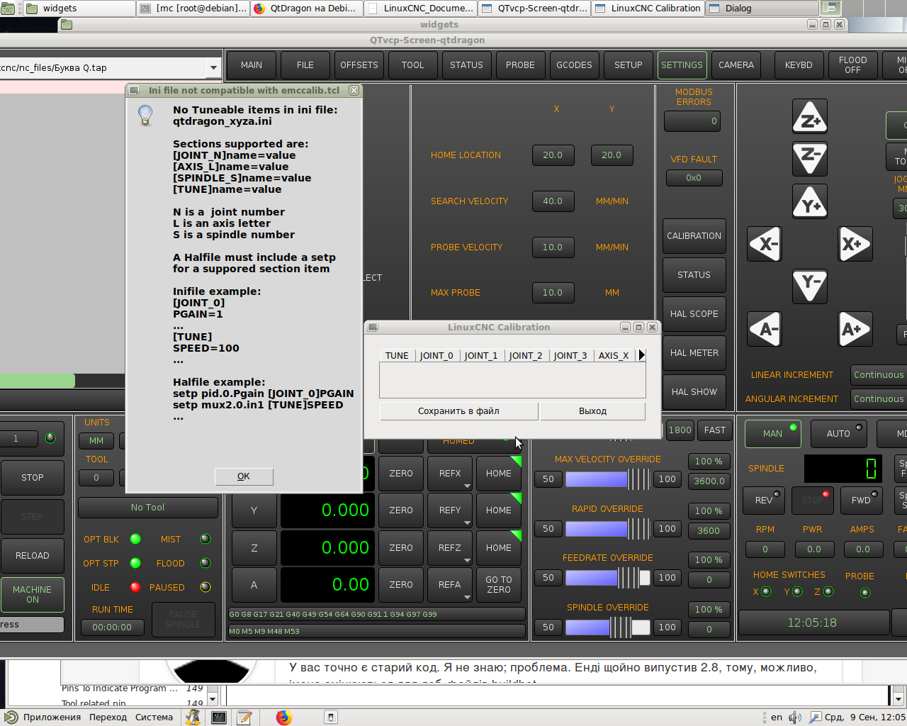

The calibration function works in AXIS, but not in Qtdragon. Also the same with "override limits'. With an axes on the limit switch, and "override limit" checked, one cannot power on the machine.

I don't quite understand your keyboard problem. Do you have the calibration button inactive?
- keyboard
- Posts: 55
- Thank you received: 4
09 Sep 2020 08:39 #181439
by keyboard
Replied by keyboard on topic QtDragon on Debian Buster, some issues
Hi hottabich,
Yes, calibration button is inactive and also override limits does not work.
BTW, is that a newer GUI ? I see the Calibration good there.

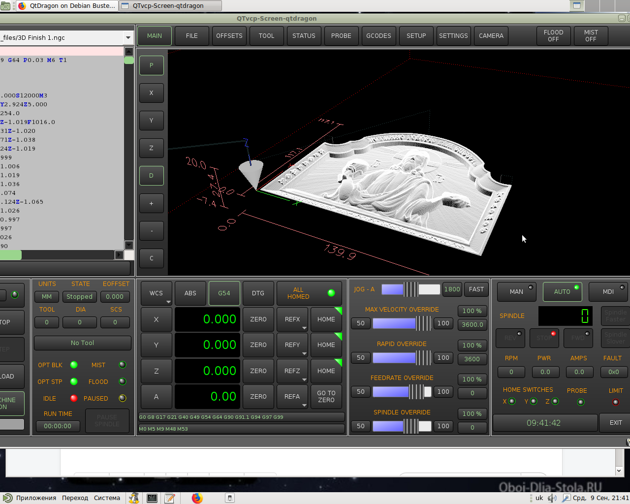

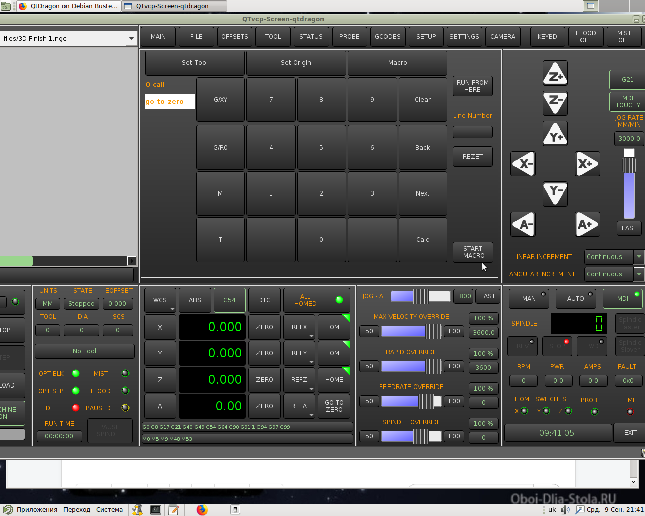

09 Sep 2020 12:09 #181469
by hottabich
Replied by hottabich on topic QtDragon on Debian Buster, some issues
This is my version of QtDragon. Download the file and unzip it to your sim.qtvcp_screens.qtdragon folder with replacement. Sensor in the NC files folder. Images in sim.qtvcp_screens.qtdragon and add missing files to it.
I just can't hang everything. On all paths, the name of Jura is replaced by its own. Especially in qtdragon.grc the operation of the calibration button depends on it.

09 Sep 2020 12:37 - 09 Sep 2020 12:38 #181473
by keyboard
thanks hottabich,
i was trying sudo update before I saw your post and it updated the GUI to the new one. Only its faded out , it doesn't have the grey colour. Setting- calibrations button now works and brings up the calibration screen. but still over travel override select not working.
i will run your files ...
Last edit: 09 Sep 2020 12:38 by keyboard.

09 Sep 2020 13:34 - 09 Sep 2020 13:42 #181484
by hottabich
Is my version open? There are some pretty good macros there.Thanks, finally getting it to update and the corrections..
