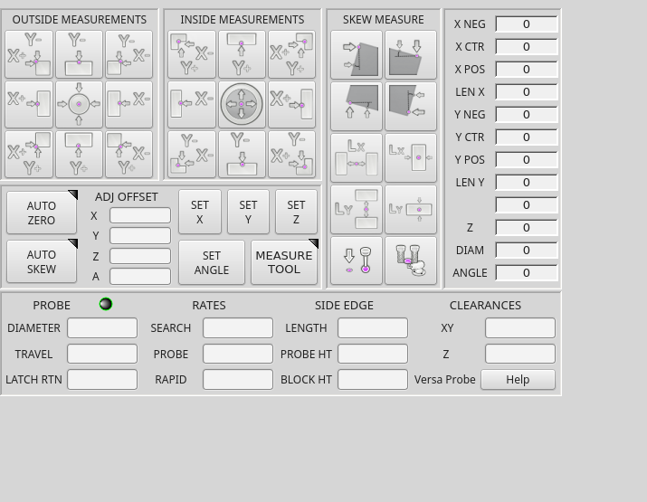

qtvcp does have a robe screen that was based from versa_probe - I think I used version2. I have not really tested it with hardware.
It could be incorporated in QtDragon as a custom screen.
but if the probing was automatic then there must be more to it then just the probe program - yes my bet would be remapped tool changes.
