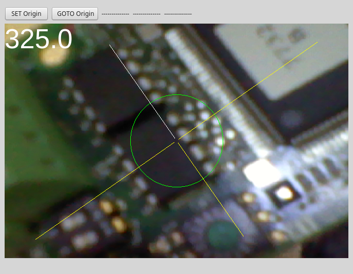

I would say yes, in case you were setting something up that was skewed and you want to rotate the axis coordinates the same amount.
Replied by persei8 on topic Camview widget
Now that it works, I can answer my opinion.By the way would it be useful to display the angle of the cross hairs when rotated?

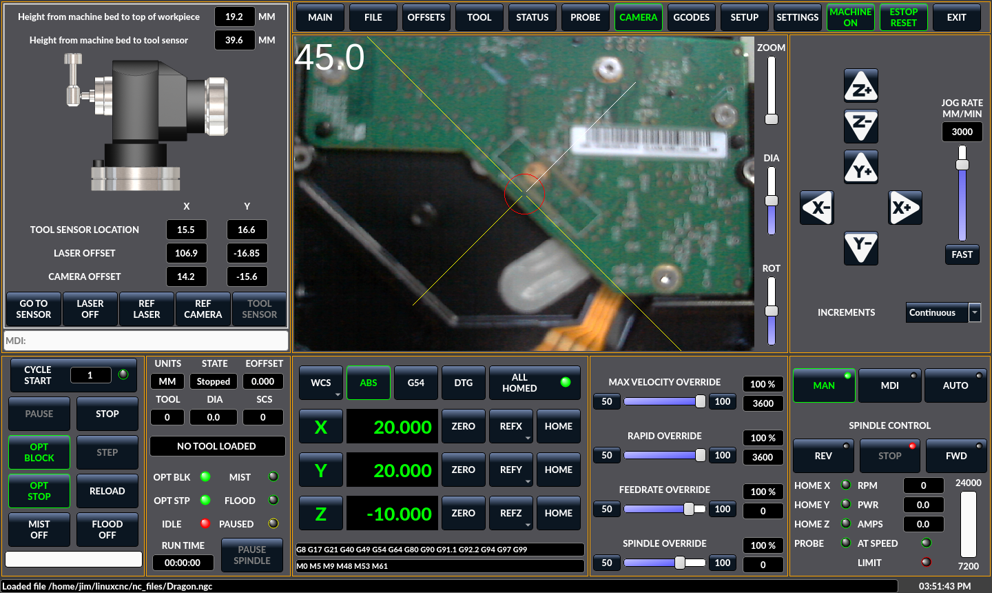

02 Aug 2020 22:00 #176946
by persei8
Very cool. Here's what my camera page looks like now.
- Posts: 7368
- Thank you received: 2181
02 Aug 2020 22:40 #176951
Replied by cmorley on topic Camview widget
That looks great. Now all we need is touch screen gesture support to get rid of the need for the controls - though I usually like controls anyway.
Do you use your laser offset to correct for camera vrs spindle offset?

02 Aug 2020 23:47 #176967
by persei8
The camera is simply an alternative to the laser crosshairs. You could mount both to the spindle plate and use either one, they are independent. Does a touchscreen support 2 finger gestures, like an android tablet? I plan on getting one eventually but I really wanted the rpi4 working first.
