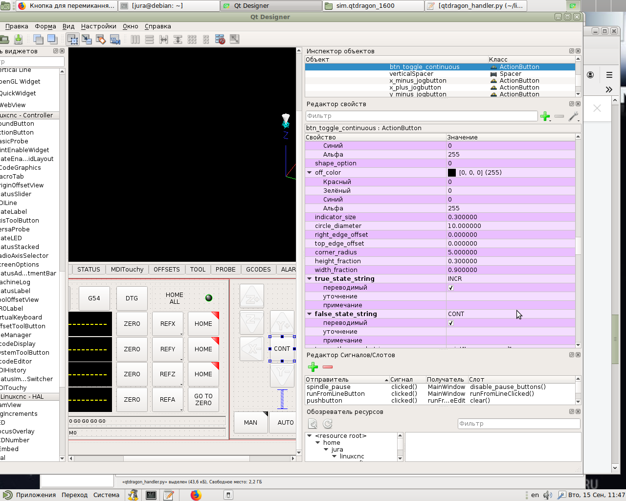

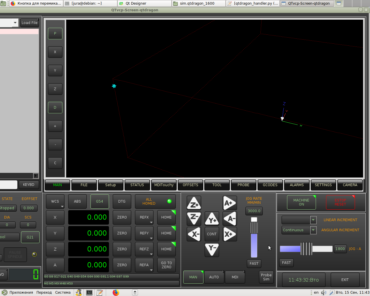

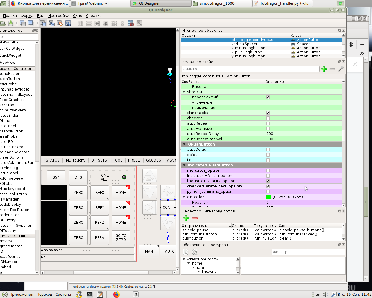

15 Sep 2020 03:56 #182194
by hottabich
Replied by hottabich on topic Button to toggle continuous jogging?
Thanks Chris, this is awesome! I've got it working (without updating linuxcnc), and it seems to work fine.
Please explain step by step how it works for you. I did everything as described above and I just switch to INCR mode, but not back and how do you set the interval? Thank you in advance!

- hottabich
- Posts: 574
- Thank you received: 96
15 Sep 2020 14:19 #182260
by hottabich
Thanks for your attention! Everything is the same but does not go back to cont. Since I don't see the meaning in this button therefore the question is closed.
