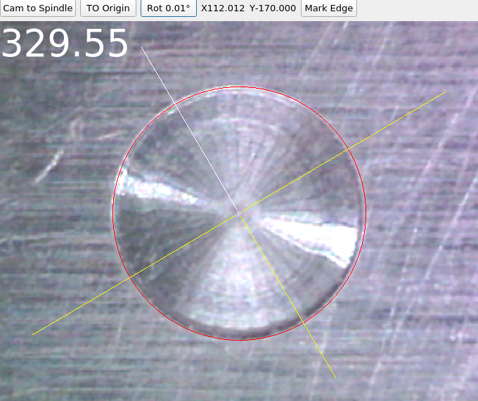

forgot - double click button 2 resets the cross
Replied by cmorley on topic QTvcp Cam View Dialog
I use a laptop to test - I hope a mouse will be the same.
button1 + scroll = zoom
button 2 + scroll = rotate cross
button 3 + scroll ( or button 1+2 + scroll) = circle diameter.

you might like this improvement:
forum.linuxcnc.org/qtvcp/40051-info-and-debug-messages?start=20
Adjustable rotation increments.

phillc54 wrote
"Rot" toggles the rotation move from 1.00o to 0.10o to 0.01o
my question is:
do i have to customize things with cam_align embedding myself in designer and editing handler file
or will some properties become integrated to the standards of cam_align ?
my question is:
Last edit: 19 Sep 2020 05:04 by partec.
I will incorporate in next uodate, when I get a chance,
