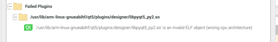

23 Sep 2020 10:08 - 23 Sep 2020 10:26 #183443
by partec
libpyqt5_py2.so not accepted in Raspberry PI4 was created by partec
Last edit: 23 Sep 2020 10:26 by partec.

26 Sep 2020 19:17 - 26 Sep 2020 19:18 #183870
by partec
Replied by partec on topic libpyqt5_py2.so not accepted in Raspberry PI4
is there also an insider tip, please?
where and how to start?

27 Sep 2020 12:58 - 27 Sep 2020 13:11 #183973
by partec
image for Raspberry PI4
linuxcnc-2.8.0-pi4
Linux linuxcnc 4.19.71-rt24-v7l+ #4 SMP PREEMPT RT Thu Apr 30 22:00:15 CDT 2020 armv7l GNU/Linux
(libpython-dev is included in the installation)
then according to Kurt's writeup about what was found out to do for x86:
gist.github.com/KurtJacobson/34a2e45ea2227ba58702fc1cb0372c40

pi@linuxcnc:~ $ locate qtvcp_plugin.py
pi@linuxcnc:~ $
link not possible
libpyqt5_py2.so 08.07.2018
says
'/usr/lib/arm-linux-gnueabihf/qt5/plugins/designer/libpyqt5_py2.so' is an invalid ELF object (wrong CPU architecture)
linuxcnc-2.8.0-pi4

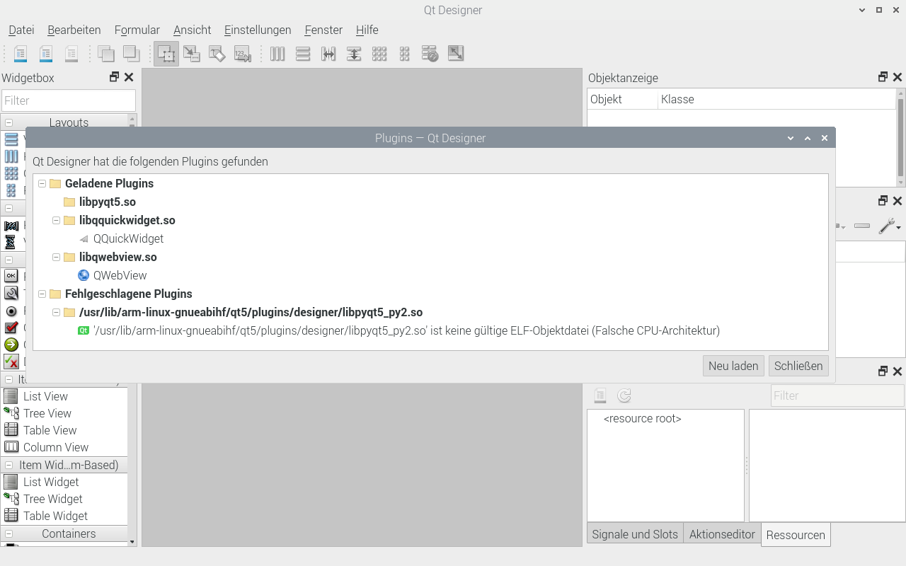

Launch Qt5 Designer
Use the PYQTDESIGNERPATH environment variable to tell QtDesiner where to look for the plugins
$ export PYQTDESIGNERPATH='/path/to/plugin/directory/'
Launch Qt5 Designer
$ qtchooser -run-tool=designer -qt=5
arm-linux-gnueabihf
libpyqt5.so
libqquickwidget.so
libqwebview.so
found
/usr/lib/python2.7/dist-packages/qtvcp/designer/x86_64/qt5.7/
but
pi@linuxcnc:~ $
link not possible
says

27 Sep 2020 23:12 - 27 Sep 2020 23:12 #184076
by partec
thank you Scott, unfortunately it did not help yet!
it says still
should we find a suitable libpyqt5_py2.so may be?
BR
Peter
