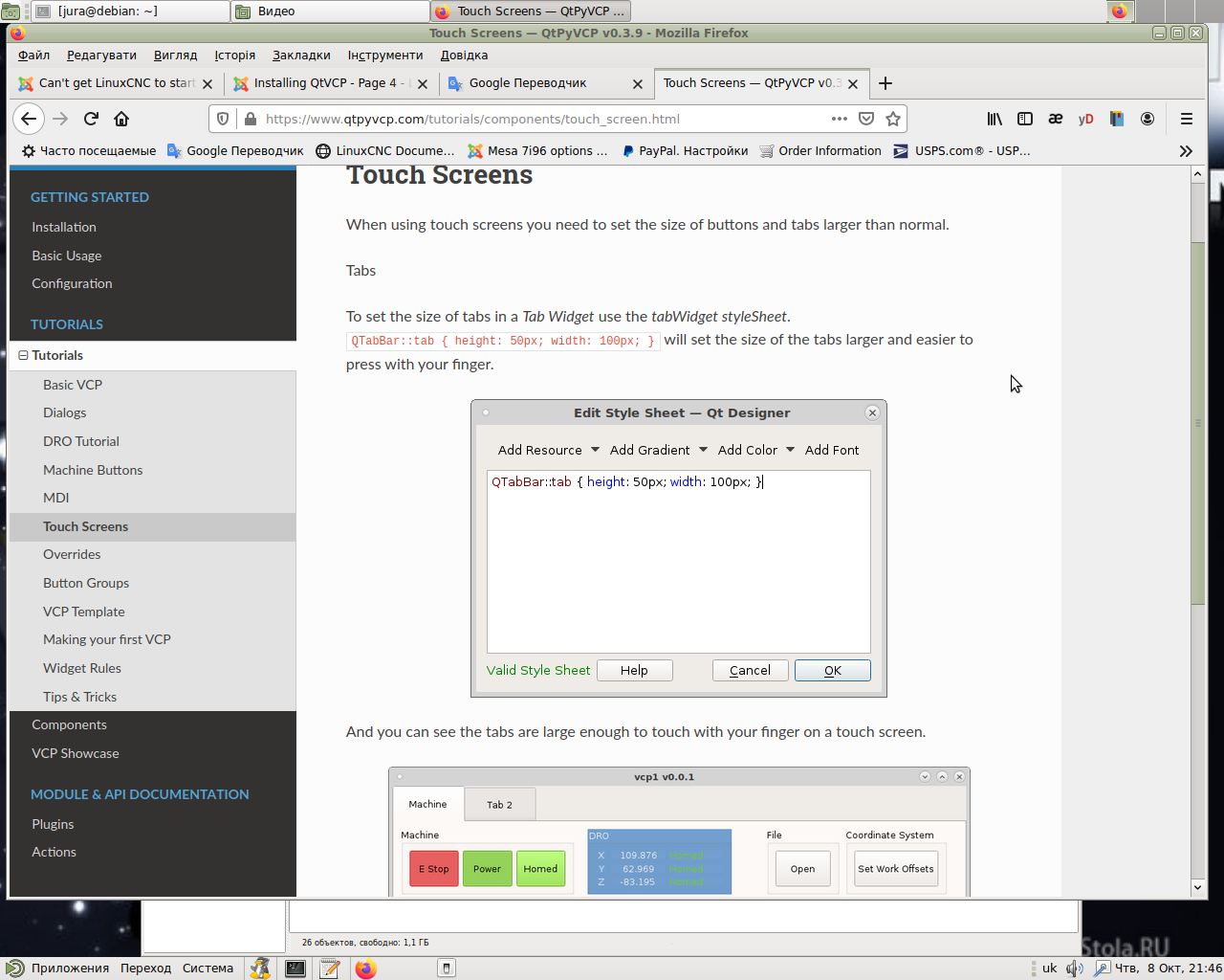

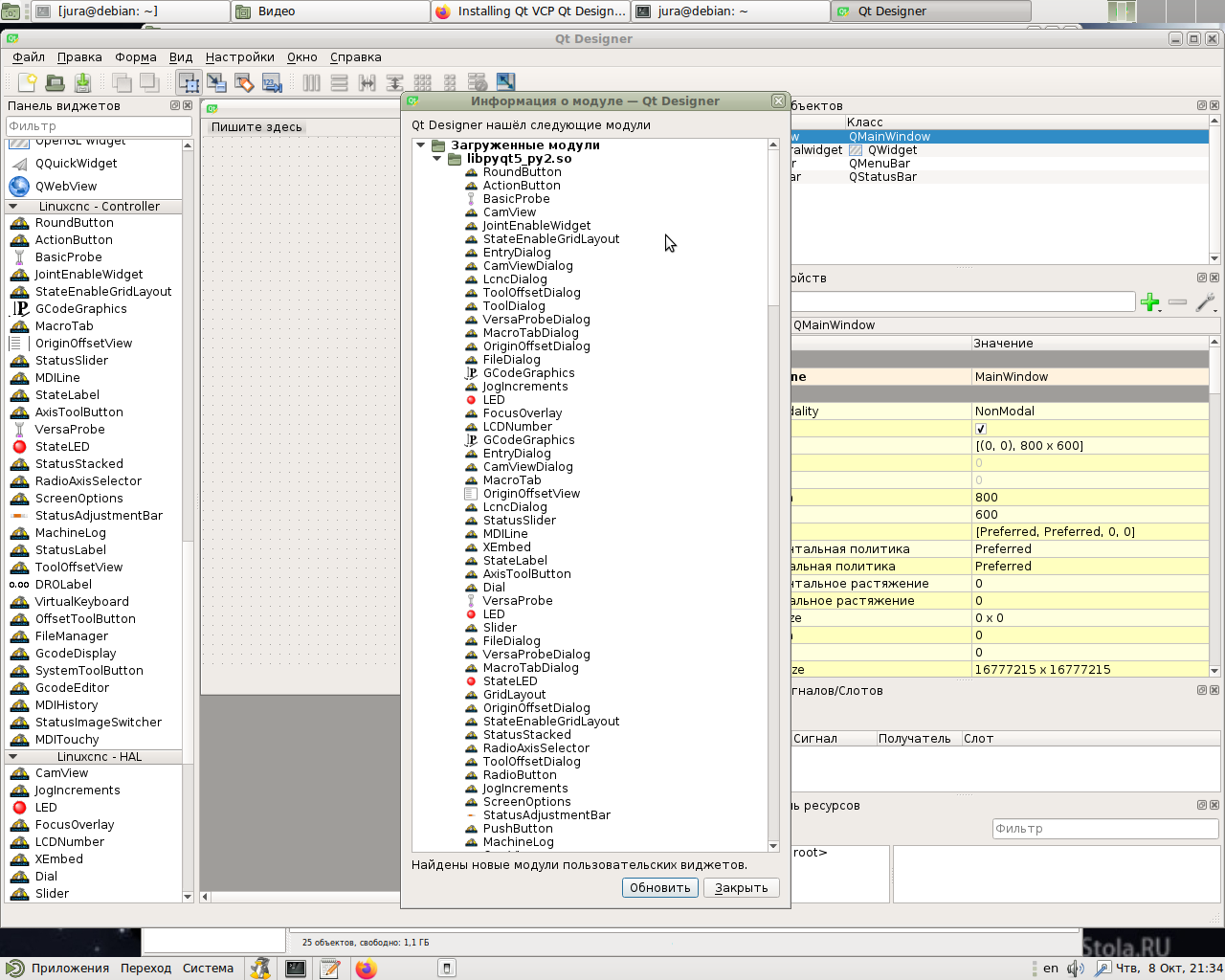

Thank you for attention! The designer has been installing for a long time, but there are installation instructions here. He looks like that. What Dragon doesn't work on the touchscreen? I don't have a touchscreen monitor.

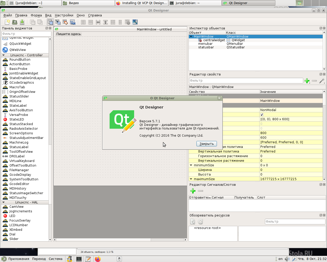

Haven't had much time to spend on this but I did get QT Designer installed and I was able to change the text on one of the buttons. Now to try adding a new button and attached functionality to it. This is all new to me. I'm used to coding in C# using Visual Studio and a tiny bit in Python.

It would be much more convenient if I could use QT Designer on my Windows laptop to work on screen changes. I know sacrilegious but it would be so convenient. I loaded QT Designer and I can open the qtdragon screen but I don't have the LinuxCNC wdigets in the tool bar on the left. Is it possible to install them on a my Windows PC? When I want to test a new screen I will copy the .ui file to my Linux machine.
