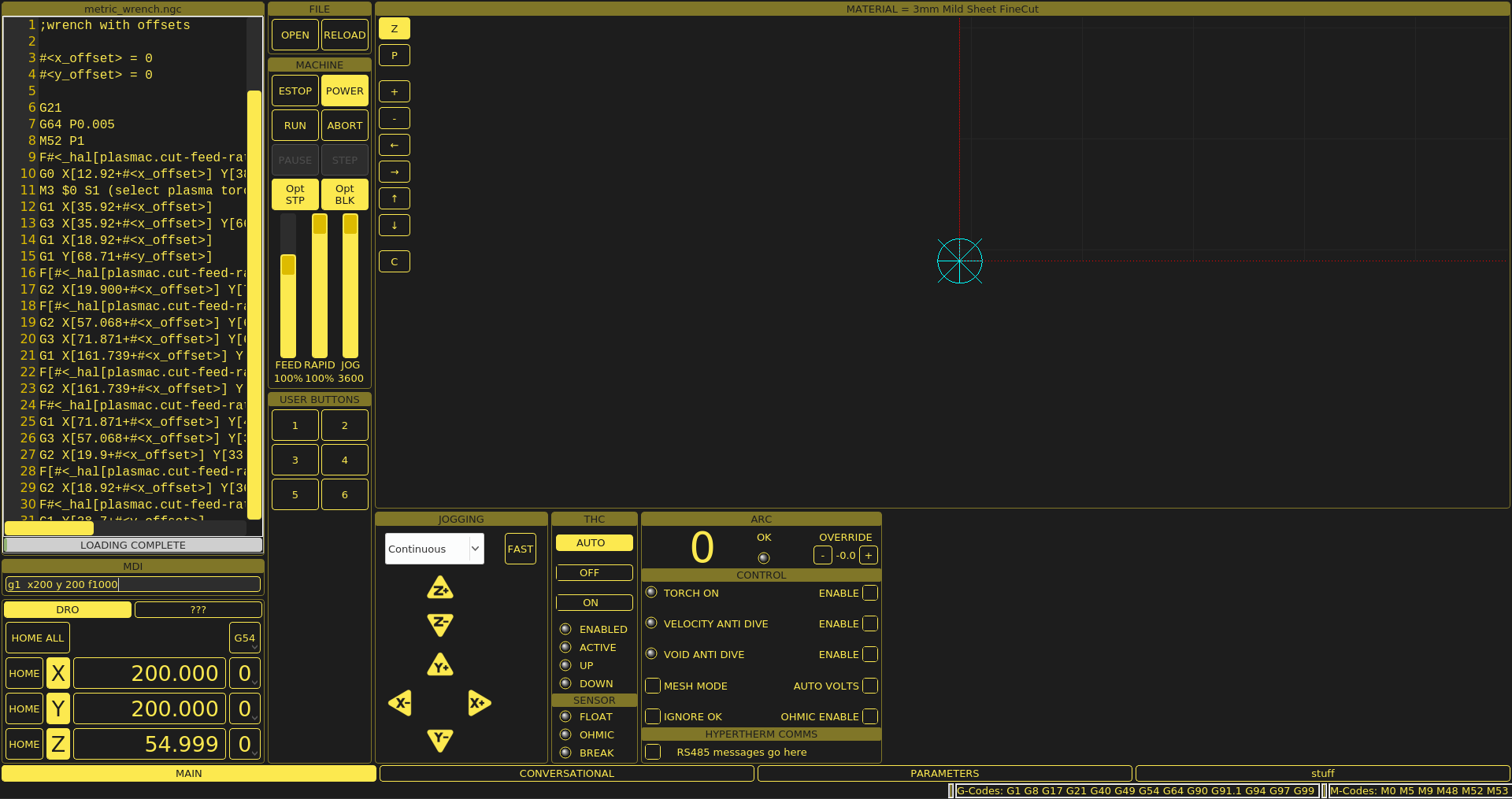

11 Oct 2020 01:03 #185666
Replied by rodw on topic QRadioButtons in preferences file
Thanks Phill, that gave me a clue to work it out. I had another RIP instance on the computer and the rip-environment did not remove it so it must have been looking in the wrong folder for it. A quick reboot and it was all good.
I know this is a work in progress.
I really like what you've done.
I really like the nice clean layout on the front page.
I noticed the part was not displayed but all the jogging and MDI shows up.
Some suggestions
1. It would be great to have a button which pops up MDI history and allow selection of an old line.
2. Then an execute MDI button would be nice. (to allow select a prior line, edit it and execute it - Gmocappy's button is not touch friendly )
3. I think there is a lot of wasted space on the front screen due to screen preview. If you think about it, a plasma table is either going to be square or rectangular with Y running up and down the screen in Z view (eg portrait view) The screen preview is in landscape mode so not really useful The screen preview could be to the left of the Arc and Control blocks and extend to the top of the screen. That would be perfect for a 1200 x 2400 table but maybe there is an option in the settings to make it a square preview for 1200 x 1200 tables. I don't know how you could utilise the extra real estate if a square preview was selected, Maybe some parameters could be moved forward in that situation.
4. I never use the perspective view so think the P button could be deleted if it is simple.
5. Could jog distance be a series of radio buttons (or buttons) under the fast button? We don't want to be wasting time with drop downs. Scrolling is not always easy on a touch screen.
I'm keen to see the next instalment...
Some suggestions

11 Oct 2020 01:13 #185668
by phillc54
Replied by phillc54 on topic QRadioButtons in preferences file
Yep, there is a lot to do...
I see on your screen the white MDI and the white jog increments, Chris had the same but I don't see that here. I think I'll build a VBox VM and see if that is different.
The part is not displayed because there is no material file parameters setup yet so the only files that load are non plasmac ones, try some of the standard examples.

11 Oct 2020 01:34 #185669
Well if you make them radio buttons, the problem goes away
They show as white on the other tabs too...
Oh and I found chips displays! Thanks!
I'd love to help but I think I'd get in the road... So much still I don't know about Linuxcnc.
I see on your screen the white MDI and the white jog increments.

11 Oct 2020 01:37 #185670
by phillc54
The real estate issue is hard to get around when trying to accommodate different screen sizes and aspect ratios...
