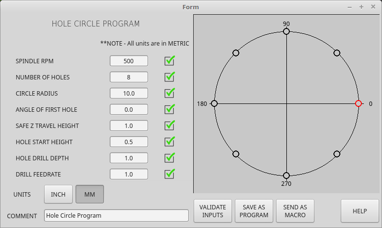

Simple like Jim's hole circle utility?
He just uses QPaint on a plain widget.
This gives a rough idea:
zetcode.com/gui/pyqt5/painting/
here is another one:
www.learnpyqt.com/tutorials/bitmap-graphics/

Jim's gcode utility is in linuxccnc master :
github.com/LinuxCNC/linuxcnc/blob/master...ility/hole_circle.py
Note in the examples from the net - you often see:
Not in example code on the often has some similar to this (note super)
Needs to be changed to similar to this python2 version of super(again note super)
