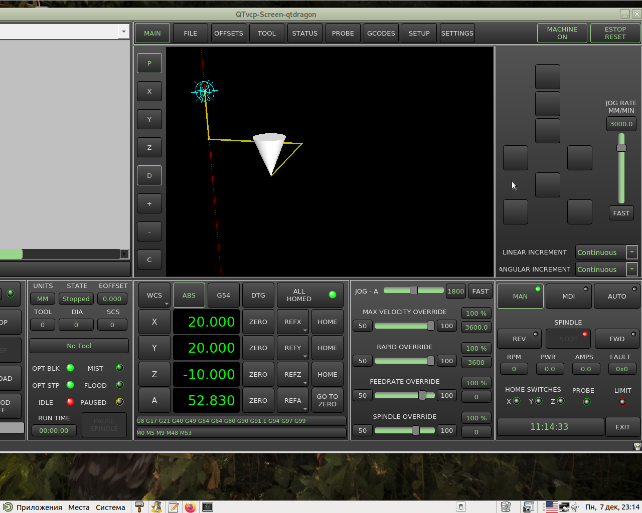

After Linuxcnc updates, when adding the Mdi Touchy widget to QtDragon, Dro A does not work. Please tell me how to fix it. Thank you!

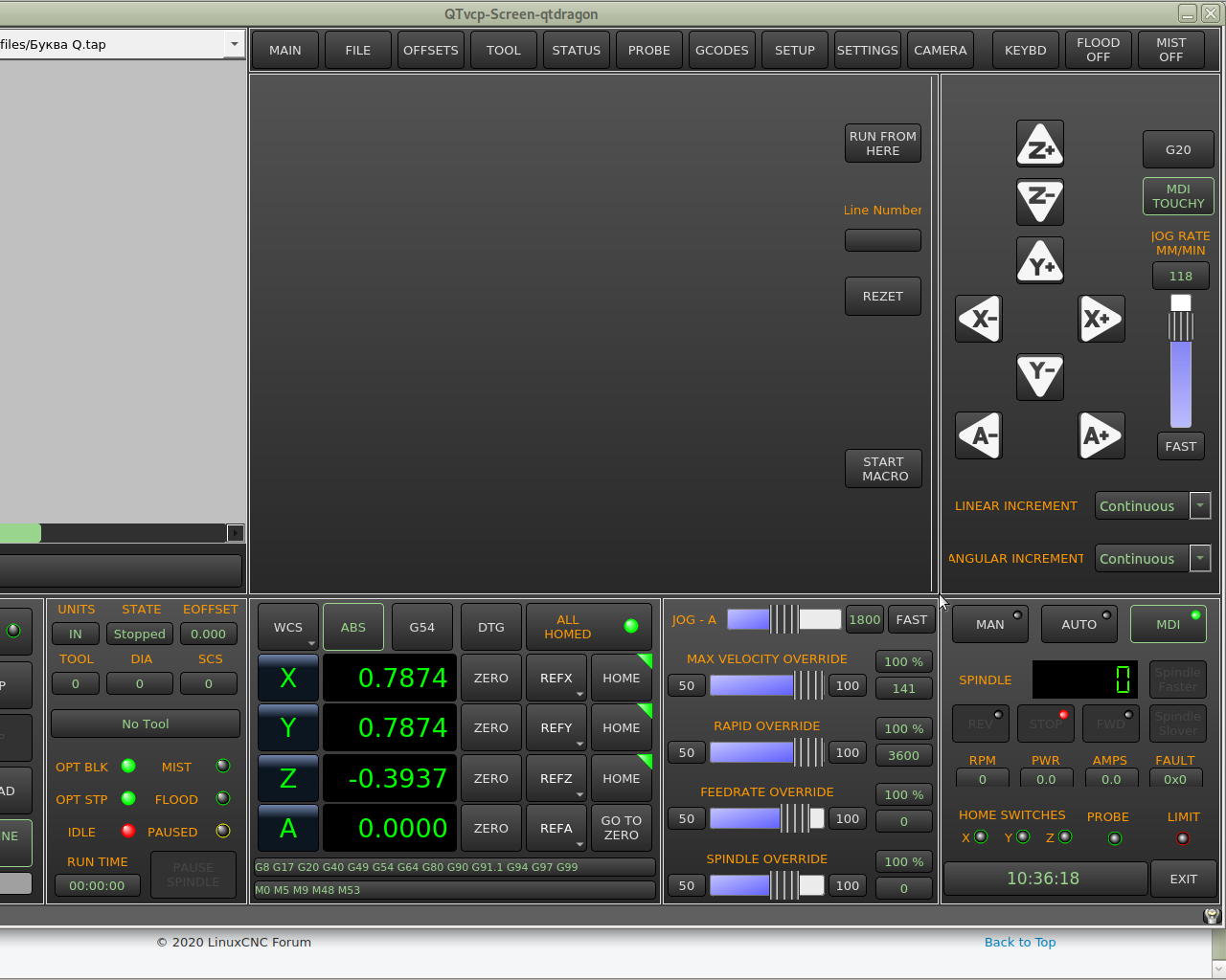

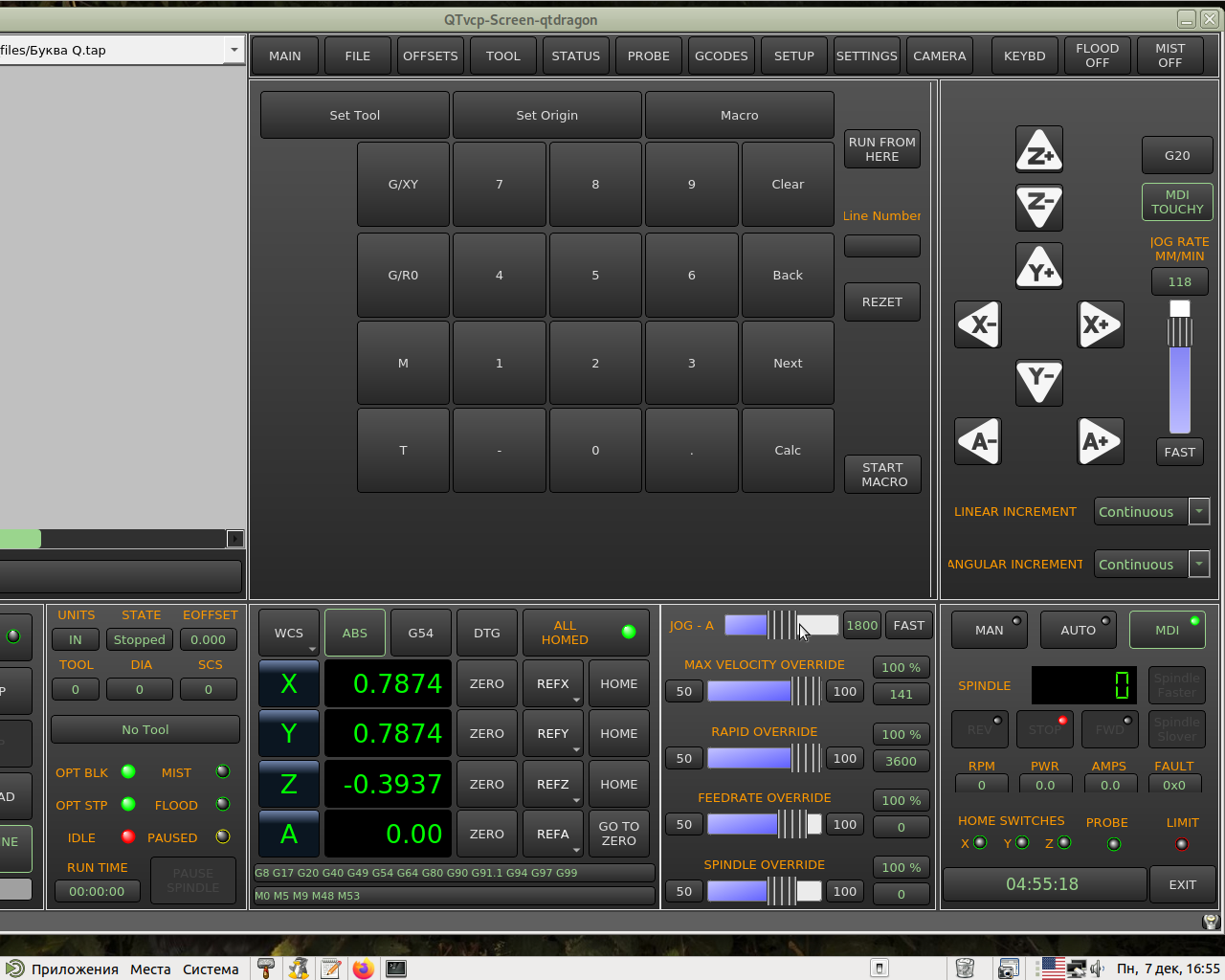

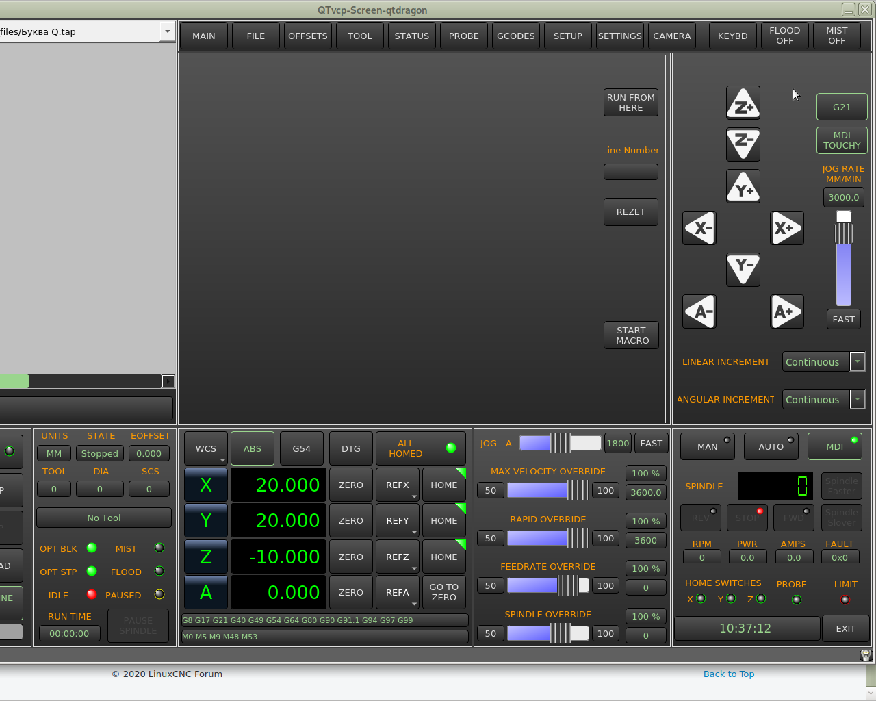

Thanks for attention. But without the widget, Dro-A counts. It all started after changing the speed sliders.
If the A axis is number 4 then the mm-inch dimension is switched.

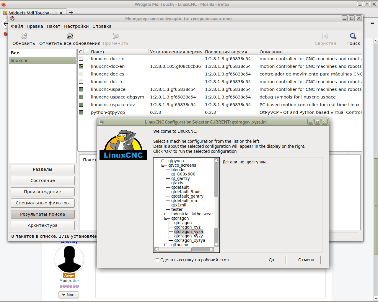

I am using Linuxcnc 2.8 as in the screenshot. Simka with 2.8 and mine, if you remove the mdi touchy widget, work the same way.

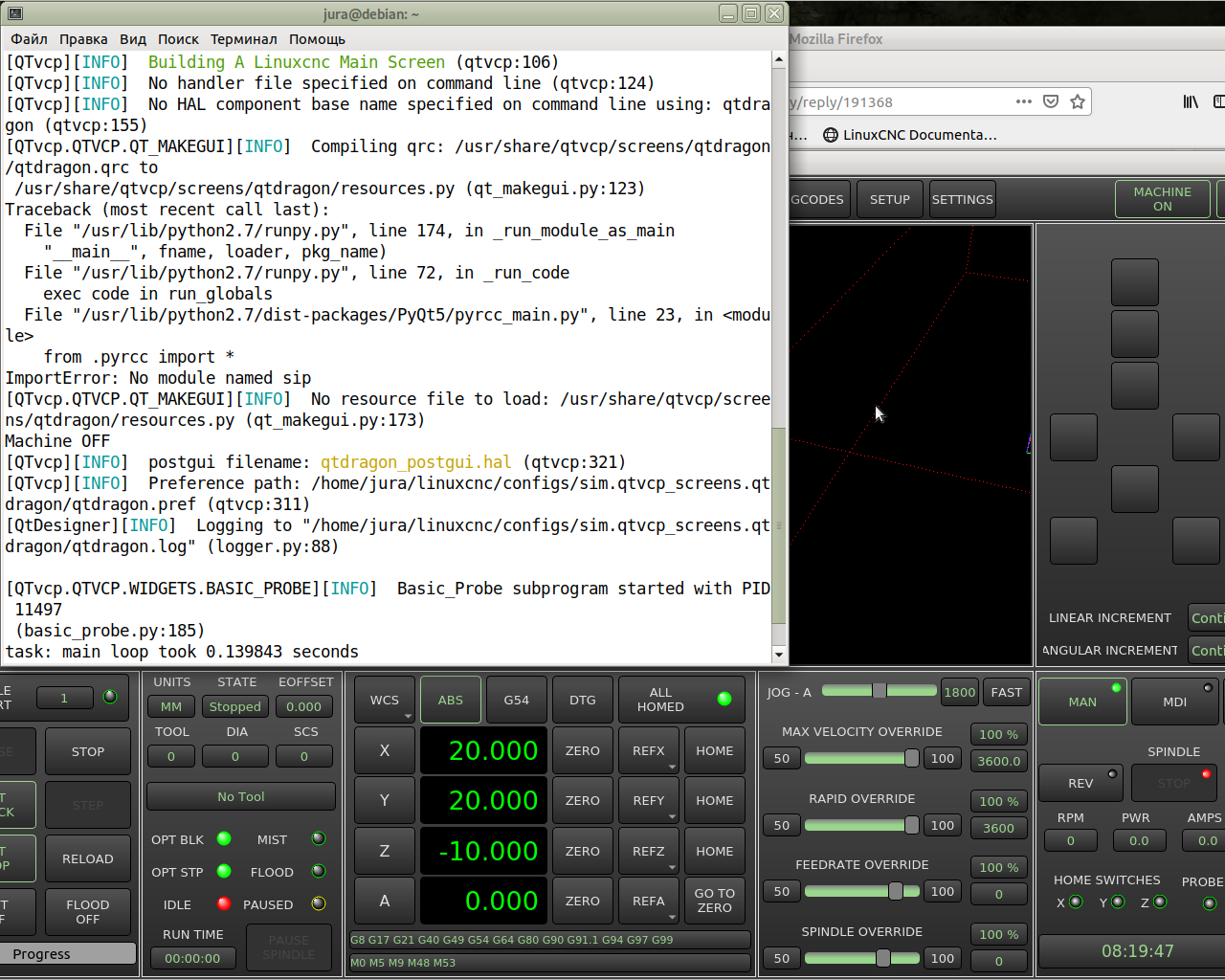

I can't duplicate the problem.
I do see you have an error related to the resource file but I'm not sure that's related.

Why is the mdi touchy widget breaking the A axis? No problem without a widget. Please upload the config and you will see what I am asking. The second config is the same but without the widget.

Are you using 2.8.1?
Are you sure linuxcnc is running the .ui file you think it is?
You can check the output in the terminal to confirm what .ui and handler it's using.

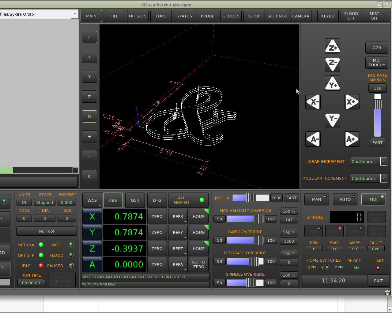

Without the widget, the commands G20, G21 change the bit width of the A axis dro, but with the widget they do not. I believe the two decimal places are correct and should not change in the designer's opinion. Axis A is practically working. Maybe I'm wrong. Thanks for attention.
