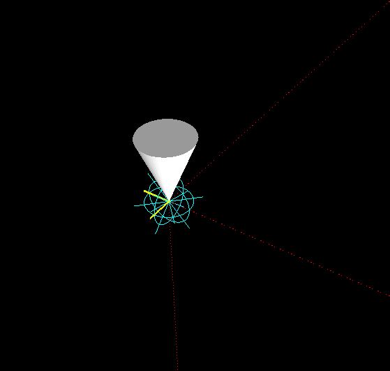

19 Dec 2020 19:57 - 19 Dec 2020 19:57 #192495 by snowgoer540
Replied by snowgoer540 on topic QTVCP Bugs?
It occurred to me that I could back out the changes manually until the push goes through.
Here is what I am talking about with the preview, and homing (yellow lines outside of the red bounding box, and the cone moves during homing). All I've done here is click "HOME ALL", but it shows axis movement during the homing sequence when it really shouldn't.
Of course, on a real machine parked away from the switches, the yellow lines are much longer.
Last edit: 19 Dec 2020 19:57 by snowgoer540.

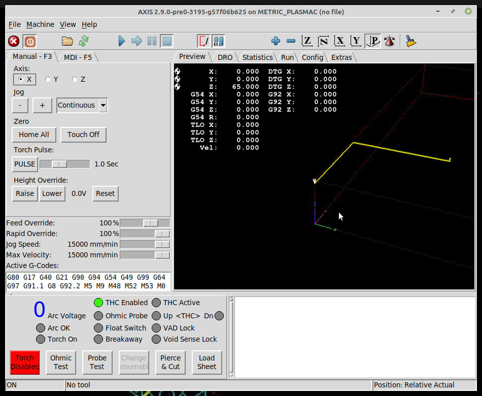

19 Dec 2020 20:29 #192497 by snowgoer540
Sorry, what I meant was I see those line on all screens.
Interesting.
So what I've seen is that Axis doesn't move the cone at all during homing as can be seen here:
And QTPlasmaC (QTVCP) does move the cone during homing as can be seen here:
Of course on a real machine, the yellow lines and movements are much longer. On a SIM the homing is obviously really short.
If you need me to get a recording from the actual table I can.

20 Dec 2020 06:30 #192522 by tommylight
Replied by tommylight on topic QTVCP Bugs?
PlasmaC sim, it does show the yellow lines when homing, but pretty sure the machines i have do not as they have tandem axis on Y:
  • snowgoer540
  • snowgoer540's Avatar Topic Author
  • Offline
  • Moderator
  • Moderator
20 Dec 2020 06:58 #192528 by snowgoer540
Interesting, that's the difference! Well at least between the Axis SIMs vs what I'm seeing on my Axis with PlasmaC installs (sim and real machine).
Maybe this is something that got "fixed" for QTVCP?
At any rate, would it be possible to "Clear live plot" at the end of the homing sequence? It's a bit odd seeing the yellow outside of the bounding box. Just a suggestion!
Thanks again!
