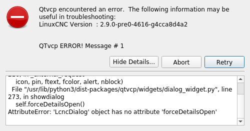

16 Sep 2021 17:58 #220824
by persei8
Replied by persei8 on topic QTVCP Bugs?
- Posts: 7368
- Thank you received: 2181
16 Sep 2021 20:24 #220844
Replied by cmorley on topic QTVCP Bugs?
ok pushed a fix. Thanks
