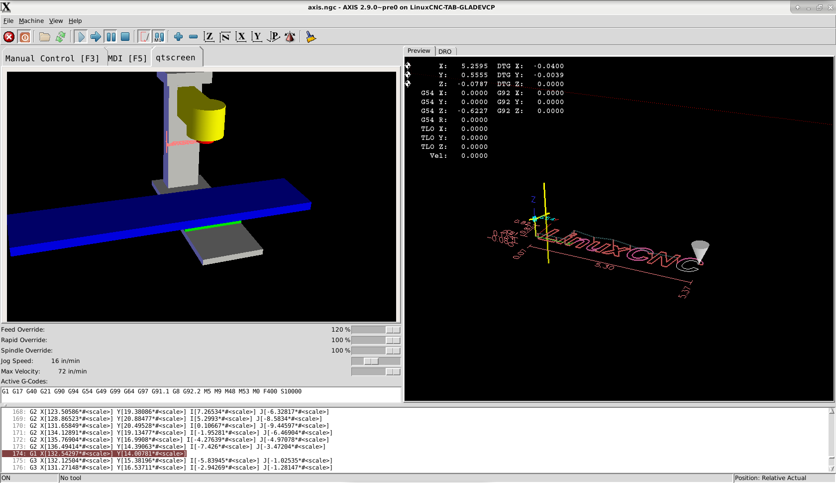

Good stuff cmorley, qt_vismach is pretty cool. it has indeed, allowed embedding into other projects.
I thought this configuration would be useful for 5axis stuff.only problem is losing keyboard jog and vismach at the same time, and it will make all your user tabs go to the left side. minor details. just a bit of usercommand.py
W = root_window.tk.call
def _dynamic_tab(name, text):
tab = widgets.tabs.insert("end", name, text=text)
tab.configure(borderwidth=1, highlightthickness=0)
return tab
W('.pane.top.tabs','configure','-width','800','-arcradius','8','-tabpady','1''1')Attachments:

20 Dec 2020 08:37 #192509
Replied by cmorley on topic QT_Vismach
Glad it worked for someone in the real world!
embedding placement is up to AXIS.
It would be nice if AXIS honored INI's {DISPLAY] EMBED_TAB_LOCATION
Maybe an AXIS expert will take that on.
If you build a nice vismach machine that you want to share let me know and I'll add it to qtvcp.
It shouldn't be hard to convert the other existing samples.
What would be really cool is if one could build a vismach machine that reads the INI and modifies it's sizes to suit a config.
I don;t think that would be too hard either.
just time
Thanks for the post.
Chris

20 Dec 2020 21:15 - 20 Dec 2020 21:23 #192574
by cakeslob
for anyone else doing vismach sims, mastercam's machsim seems like an nice tool for setting up a simulation file and constraints, and outputs all the coordinates to an xml file that can be transferred over to a vismach py file. the educational version of mastercam is free and as far as i know, does everything except post gcode, so the simulator portion should be available to play with without doing anything illegal
probably the best option. as soon as i was playing with the embedding, i realized embedding is great, but its limiting.
edit. might as well post it now so theres less confusion later, qt_vismach will not work on pi4. on the embedded version the error destroys before you can read it, but it says the same thing ,more or less, as the gcode graphics error , and will only display an empty tab
Replied by cakeslob on topic QT_Vismach
having it change side via INI file is no problem, , only issue im having is getting them to load in more than 1 spot. i can only get it to do left or right and not both.It would be nice if AXIS honored INI's {DISPLAY] EMBED_TAB_LOCATION
if inifile.find("DISPLAY", "EMBED_TAB_POSITION") == "LEFT":
tab = widgets.right.insert("end", name, text=text)
else:
return tab

20 Dec 2020 21:38 #192582
AXIS only looks for one set of INI EMBED settings.
GMoccapy,Gscreen and Qtvcp allow many.
Here is the search code from GMoccapy:
Then they are processed separately.
Again Gmoccapy:
def get_embedded_tabs(self):
# Check INI file for embed commands
# NAME is used as the tab label if a notebook is used
# LOCATION is the widgets name from the gladefile.
# COMMAND is the actual program command
# if no location is specified the main notebook is used
tab_names = self.inifile.findall("DISPLAY", "EMBED_TAB_NAME")
tab_location = self.inifile.findall("DISPLAY", "EMBED_TAB_LOCATION")
tab_cmd = self.inifile.findall("DISPLAY", "EMBED_TAB_COMMAND")
if len(tab_names) != len(tab_cmd):
return False, False, False
if len(tab_location) != len(tab_names):
for num, i in enumerate(tab_names):
try:
if tab_location[num]:
continue
except:
tab_location.append("notebook_mode")
return tab_names, tab_location, tab_cmdThen they are processed separately.
ok, bear with my ignorance for a moment, if I just take those to definitions, and change them to relate to axis dynamic tabs and tkinter, would that do what we are looking for?
- Posts: 7368
- Thank you received: 2181
21 Dec 2020 10:57 #192619
Qtvcp uses the same process to build vismach then the Tk version does.
Those functions were based on the AXIS code, so shouldn't be too hard to convert back.
The main difference would be GMoccapy uses the actual name of the widget to embed into.
For AXIS, I think it would be better to pick some key words like LEFT, CENTER, RIGHT, BOTTOM.
Chris
