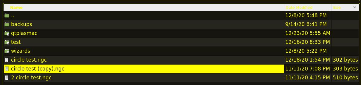

One of the recent file manager updates added some welcomed additions. But no good deed... haha.
With the header came a bit of a color change. As can be seen below, the header has a grey background that makes the font hard to read. Is there an easy way to change the styling of this particular section?
Thanks!
Thanks!

Replied by cmorley on topic File Manager Header Colors
play around with this added to the sylesheet:
If you are interested - here is not a bad reference of stylesheets.
doc.qt.io/qt-5/stylesheet-examples.html#customizing-qheaderview
QHeaderView::section {
background-color: foregnd;
color: white;
border: 1px solid #6c6c6c;
}If you are interested - here is not a bad reference of stylesheets.

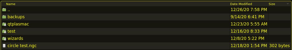

Well that got me there, albeit maybe a discovery is made too...
I'm on Mint 19.2. The color changes for Phill by just setting the background color.
For me, I have to set the background color and the border as well:
Results in this:
Without the border line, the color refuses to change on Mint it seems.
Thanks for pointing me in the right direction. I will definitely check out the link you provided.
#filemanager QHeaderView::section {
background-color: backalt;
border: 1px solid backalt;
}Results in this:

We've discovered that
works as well.
border: none;works as well.
