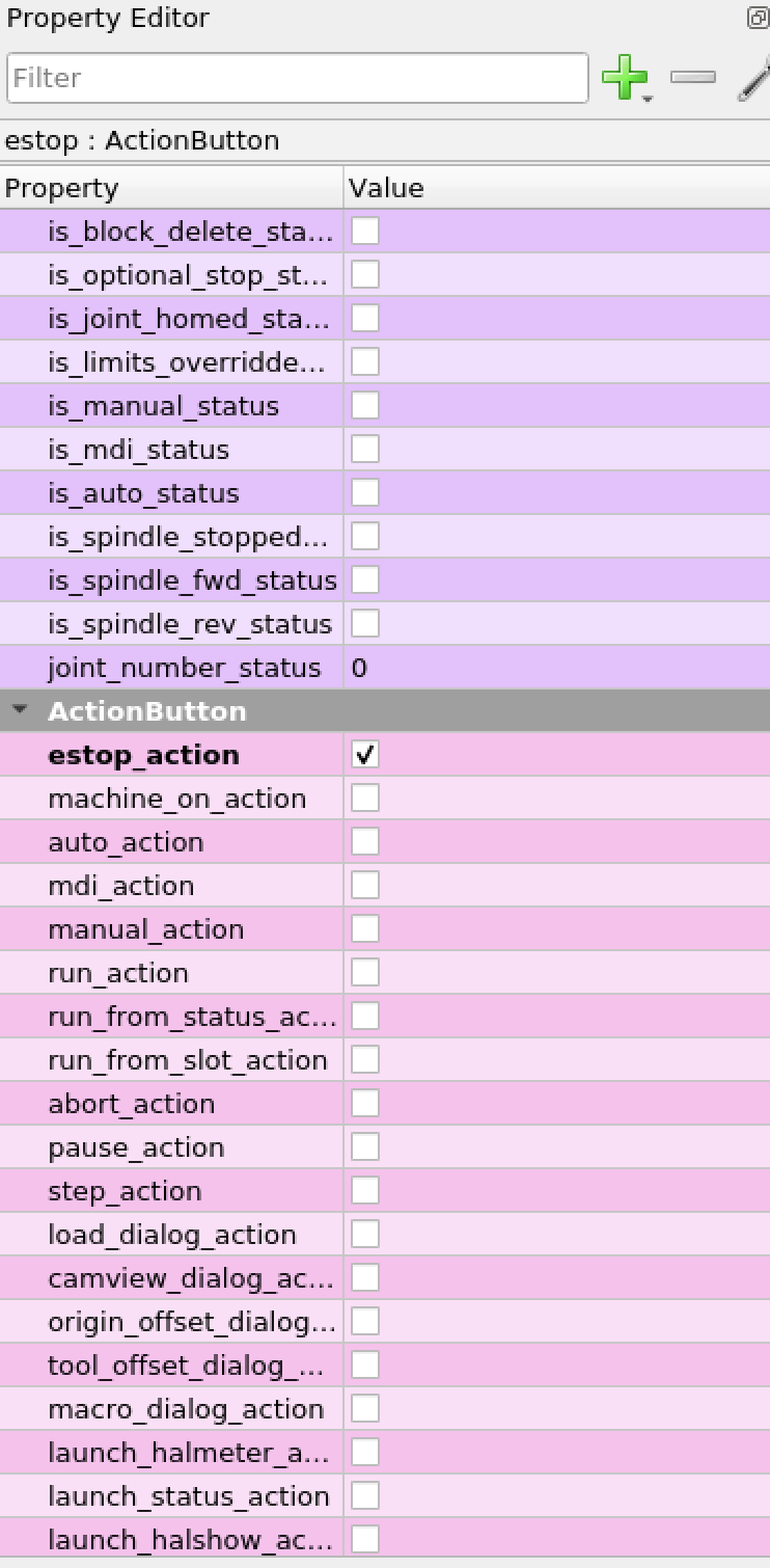

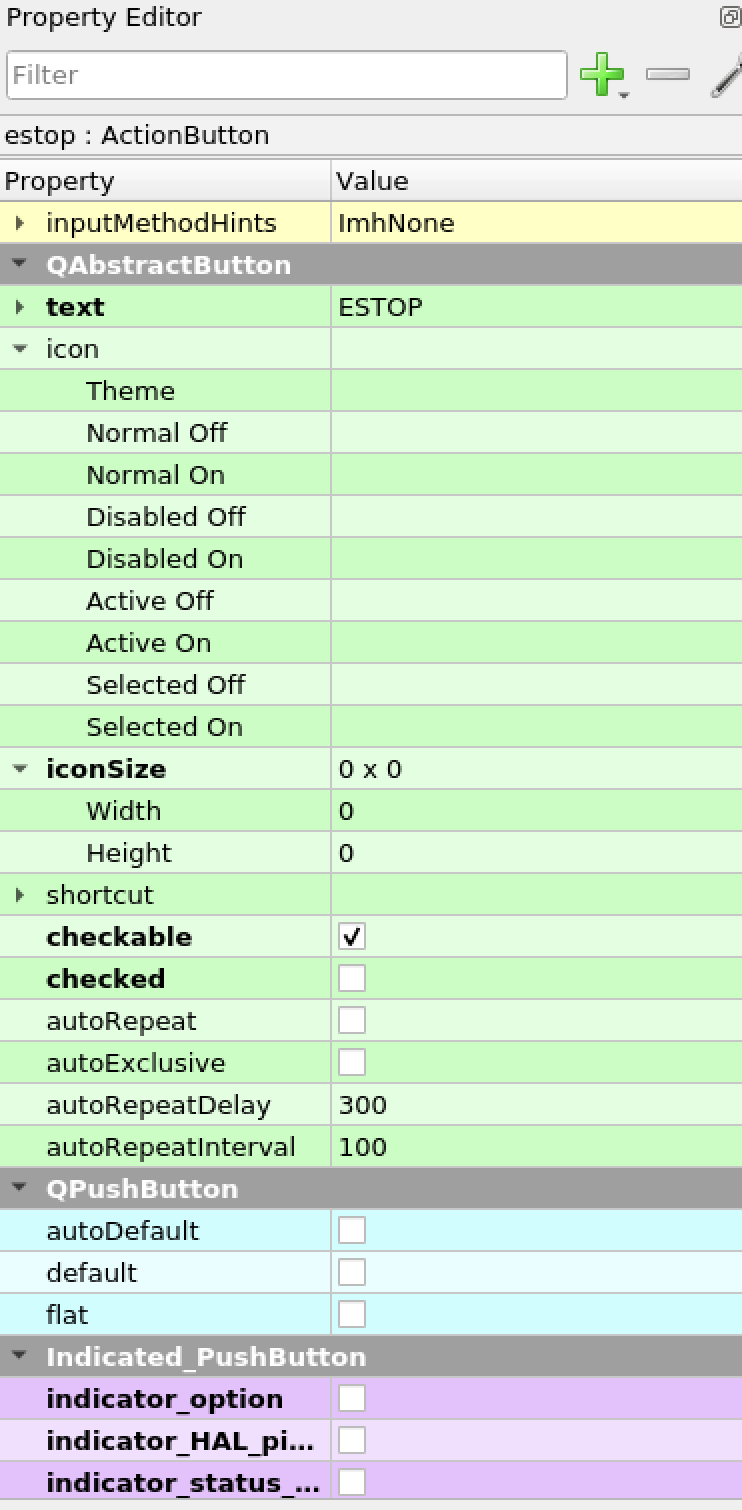

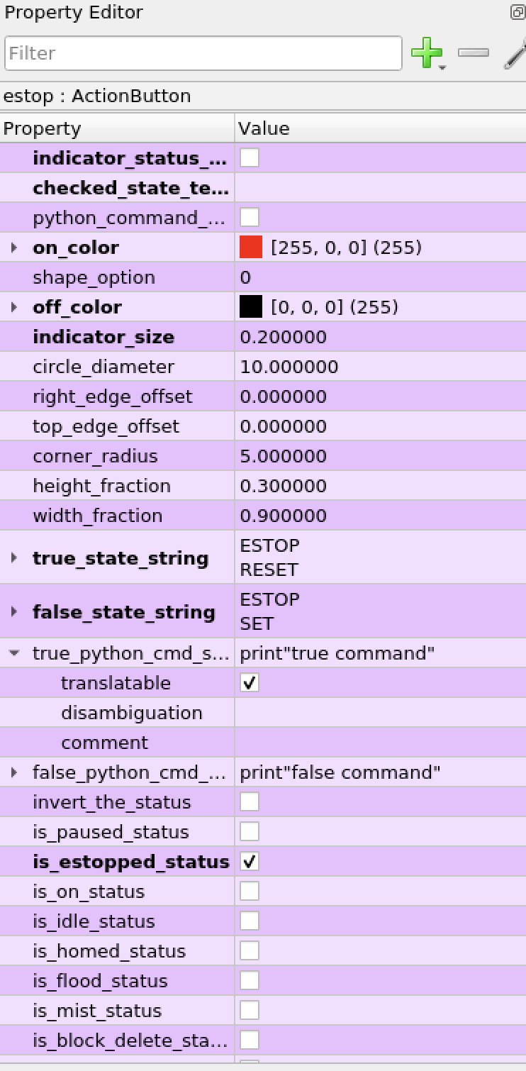

Replied by cmorley on topic ESTOP button behavior
I need more info.
Is the gui estop a check button or momentary?
how does the estop chain get from hardware to linuxcnc?
Yes the estop as coded assumes it can estop/clear at any time.
It should follow the state of linuxcnc though.
I can see it needs some work with hardware handshaking.
I'll have to delve into it a bit.

by phillc54
It is a Qtvcp ActionButton.
Replied by phillc54 on topic ESTOP button behavior
I need more info.
