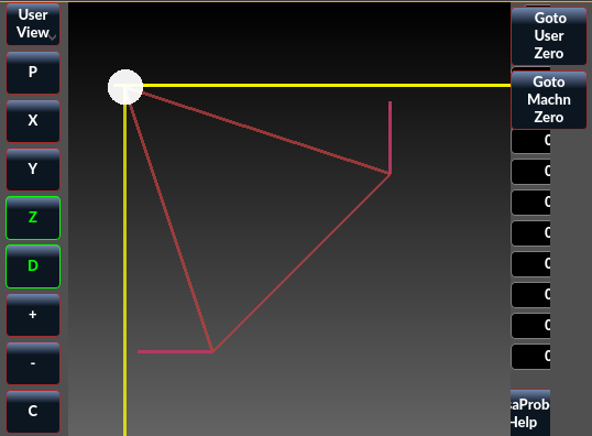

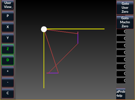

02 Feb 2024 04:15 #292189
Replied by cmorley on topic Qtvcp Development Discussions
Discussion of fix for versa corner probing in 2.9...
Before:
after:
Change:
Before:
after:
Change:
