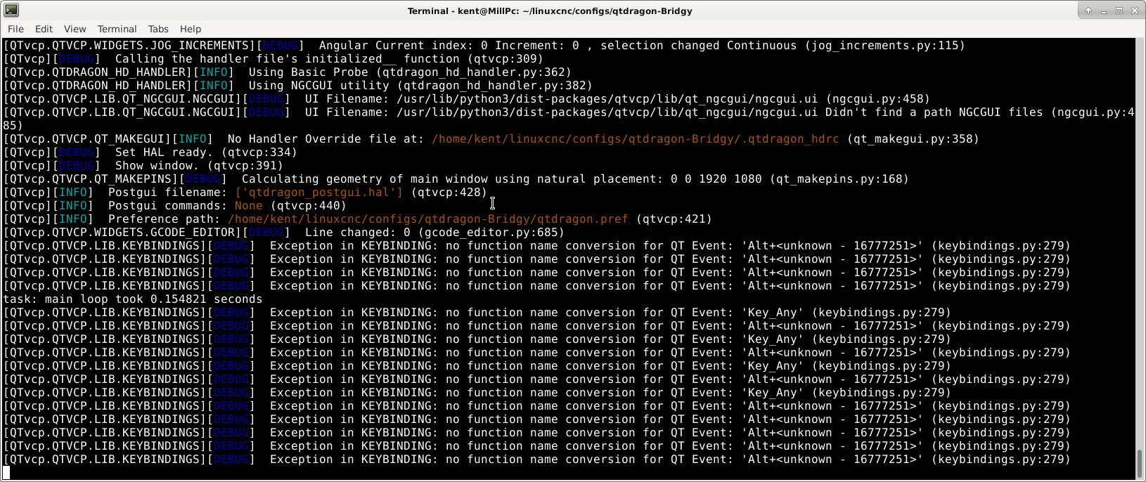

can you set the ini to:
DISPLAY = qtvcp -d qtdragon
Then run linuxcnc from a terminal.
after qtdragon loads, press estop to get the focus on wtdragon then press the space bar.
You should see some debug output in the terminal.
please post what its says about the 'key_any'

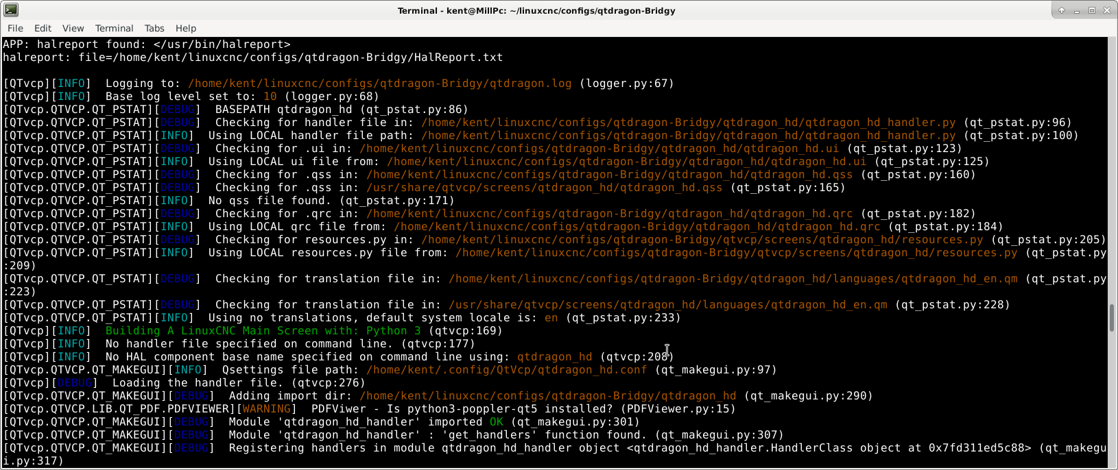

also just after loading you should see something like this in the terminal:
[QTvcp.QTVCP.QT_PSTAT][DEBUG] Checking for handler file in: /home/chris/emc/configs/sim/qtdragon/qtdragon/qtdragon_handler.py (qt_pstat.py:96)
[QTvcp.QTVCP.QT_PSTAT][DEBUG] Checking for default handler file in: /home/chris/emc/share/qtvcp/screens/qtdragon/qtdragon_handler.py (qt_pstat.py:102)
[QTvcp.QTVCP.QT_PSTAT][INFO] Using DEFAULT handler file path: /home/chris/emc/share/qtvcp/screens/qtdragon/qtdragon_handler.py (qt_pstat.py:105)
please post that too.

- turbostew
- Posts: 129
- Thank you received: 8
18 Nov 2022 05:15 - 18 Nov 2022 05:16 #257006
by turbostew
Replied by turbostew on topic Spacebar as a pause button not working
Last edit: 18 Nov 2022 05:16 by turbostew.
- Posts: 7360
- Thank you received: 2173
18 Nov 2022 18:44 #257054
Replied by cmorley on topic Spacebar as a pause button not working
In qtdragon_hd, the function name uses capitals:
KEYBIND.add_call('Key_Any', 'on_keycall_PAUSE')
I bet thats the problem.
Again I fixed these problems in 2.9, thanks for the report/questions
