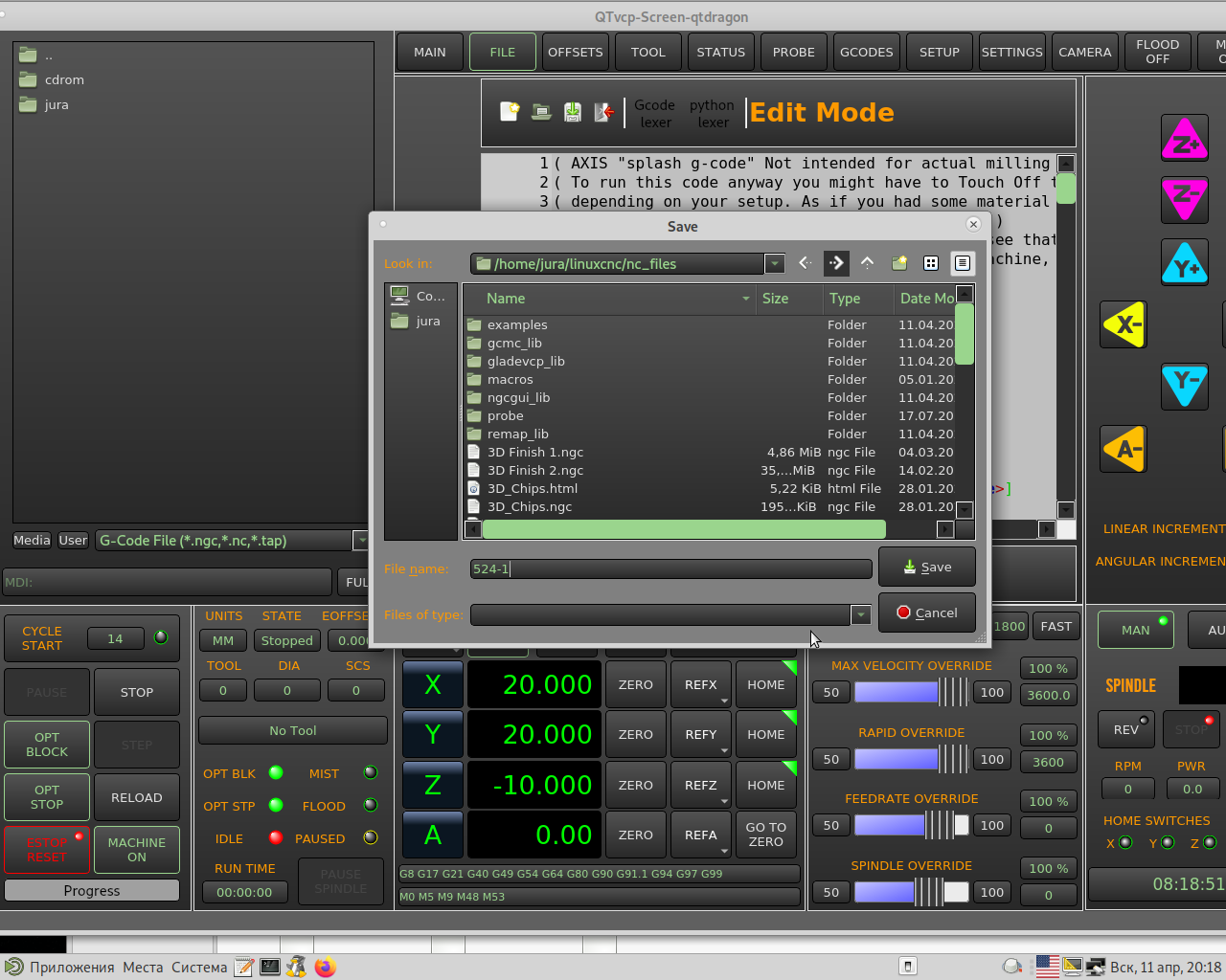

I've run into an issue in QtPlasmaC that I believe gcode_editor.py to be responsible for. I say that because I did some poking around and I see the same issue in QtDragon.
The issue comes with saving a file that was edited with the editor and giving it a different name.
Steps to reproduce:
1. edit a file
2. save the file
3. the editor for both qtdragon and qtplasmac has a GCode filetype option, click that
4. type in the file name, but omit the extension ("test" for example)
5. click save

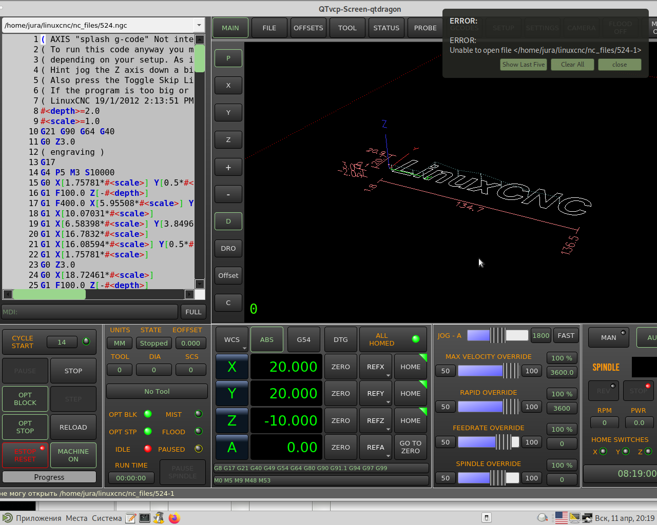

At this point, the file "test.ngc" will be saved in the folder you selected. However you will get the following error:
"Unable to open file </home/plasma/linuxcnc/nc_files/test>
can't open /home/plasma/linuxcnc/nc_files/test"
So, it seems that it is being saved to the file system correctly, but when the file name is being passed to open/reload the file, the extension is missing.
Possibly worth noting, that if you type in "test.ngc", it will save "test.ngc" in the file system, and it will open without error. A bit odd as I would have expected it to save "test.ngc.ngc", but it does not.

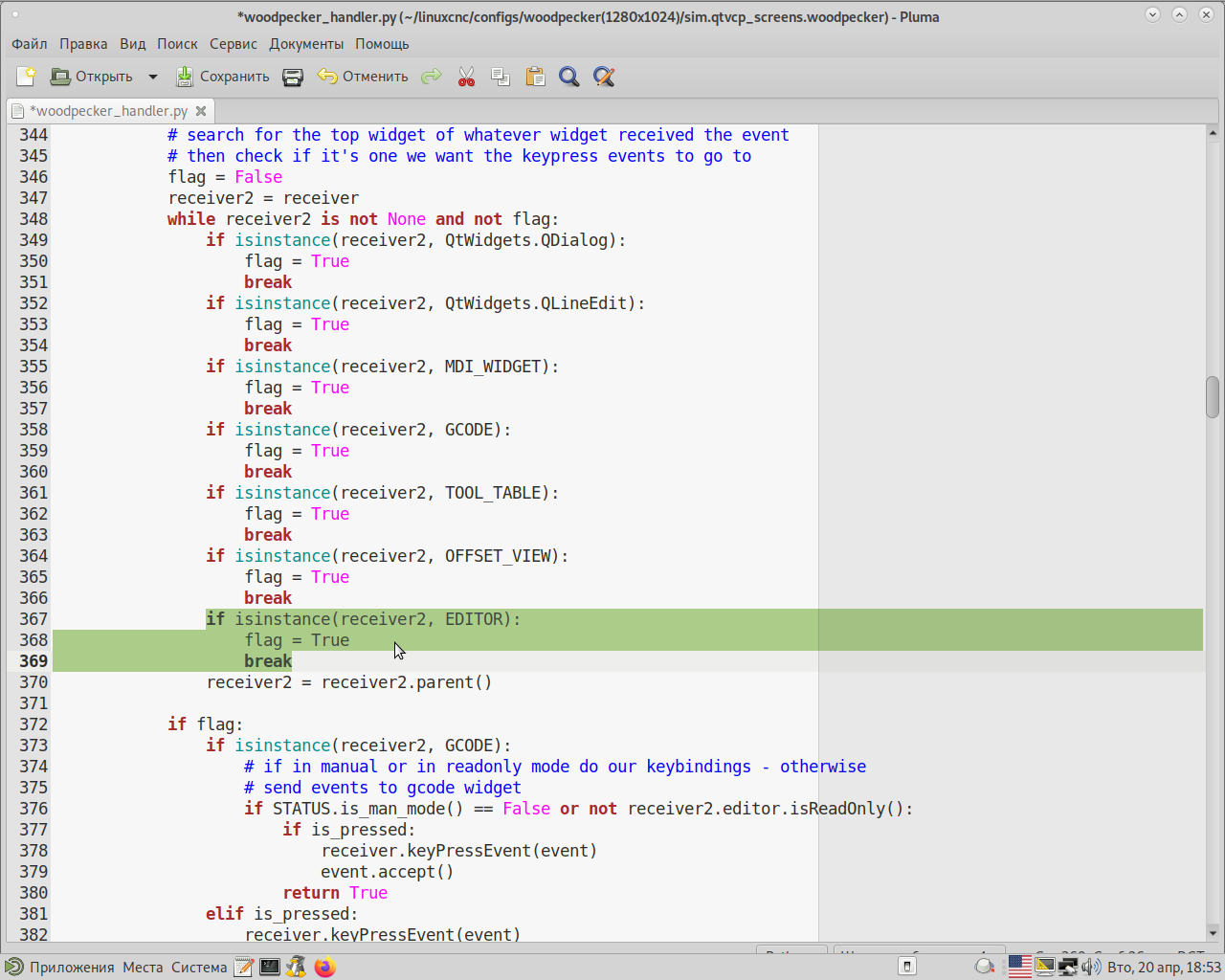

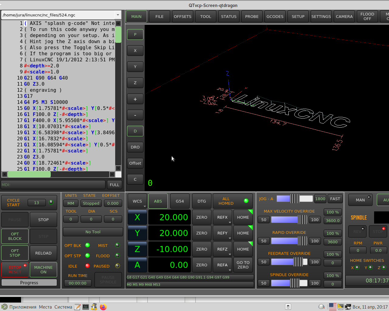

11 Apr 2021 12:41 - 11 Apr 2021 13:44 #205661 by hottabich
Replied by hottabich on topic Gcode Editor saving issues
In linuxcnc 2.8.1 works great. If we do not specify the file extension, we will get an error (but why do that). We edit the uploaded file, save it by choosing replace and that's it. You can add a version number. I also added to the handler
if isinstance(receiver2, EDITOR):
               flag = True
               break
          receiver2 = receiver2.parent()
Last edit: 11 Apr 2021 13:44 by hottabich.
11 Apr 2021 12:55 #205663 by cmorley
Replied by cmorley on topic Gcode Editor saving issues
i changed it in master so it will add the ending before trying to reload.

20 Apr 2021 11:01 #206539 by hottabich
If I add stocks to the handler as in the screenshot, then the Editor works as I want and the hint does not interfere when writing a filename, but use_keyboard breaks down. How can I fix this? Thank you.
