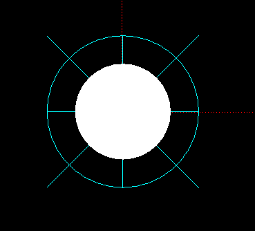

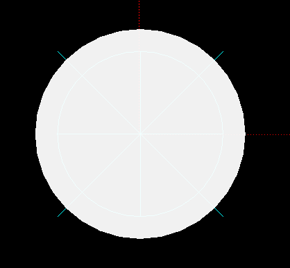

10 Apr 2021 14:06 #205546
by snowgoer540
Replied by snowgoer540 on topic Cone Transparency
I take that back...
Oddly, it is transparent when looking down on it, until you load a program. Then the transparency goes away (from Z orientation).
If I click P, I can see through 1 wall of the cone, but not both.... shrug. weird.

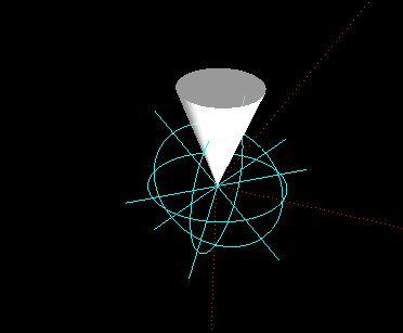

10 Apr 2021 14:09 #205547
by snowgoer540

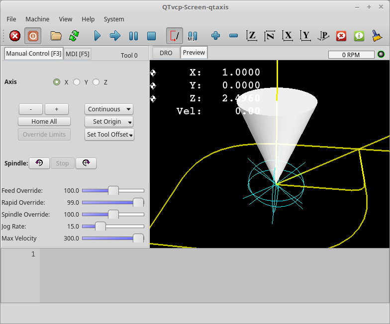

10 Apr 2021 16:54 #205574
Replied by cmorley on topic Cone Transparency
ok pull again and try - the cone might be a bit darker now though.
The following user(s) said Thank You: phillc54, hottabich, snowgoer540
- snowgoer540
- Posts: 2582
- Thank you received: 907
10 Apr 2021 17:12 #205578
by snowgoer540
That did the trick, looks great!
Thanks Chris.

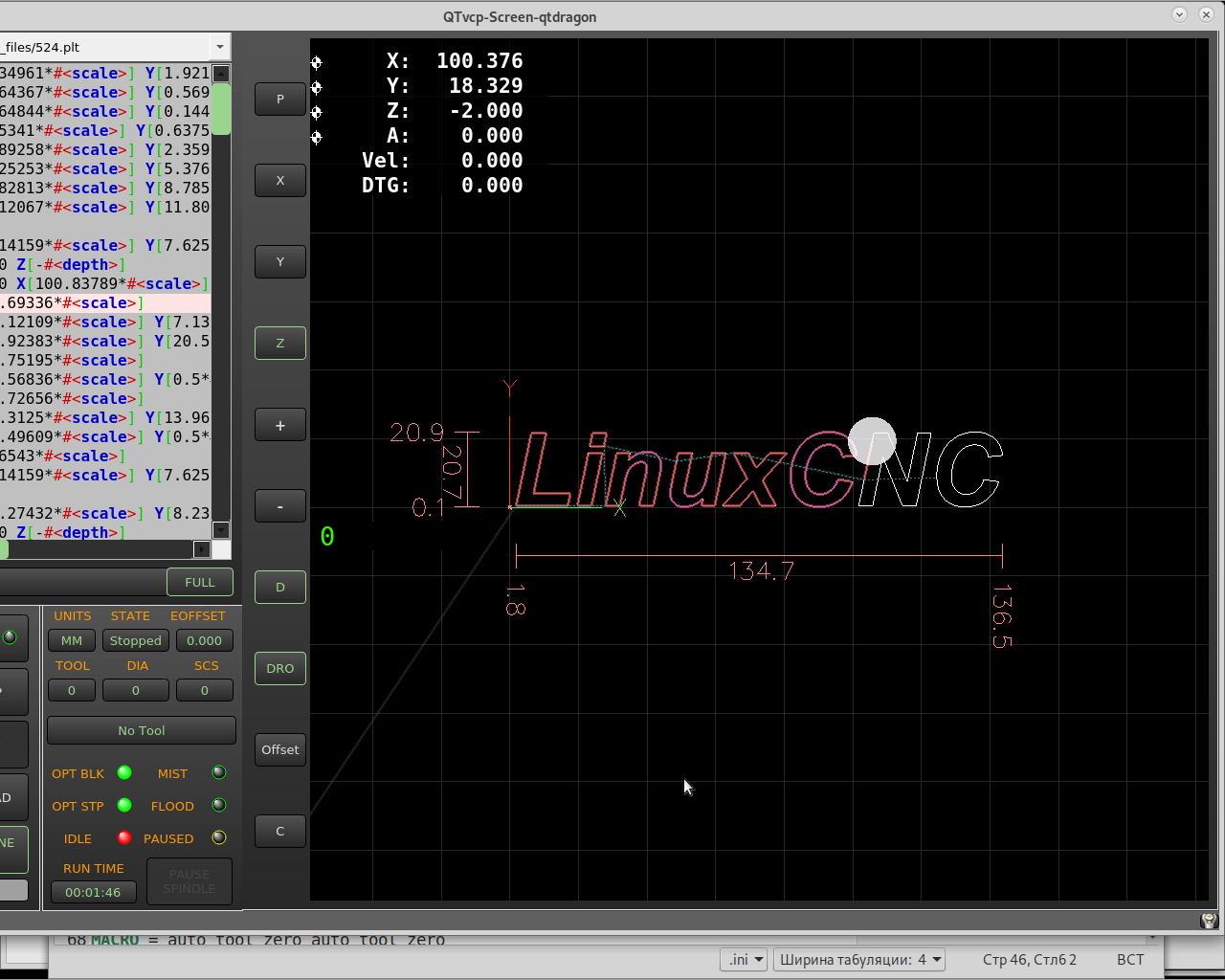

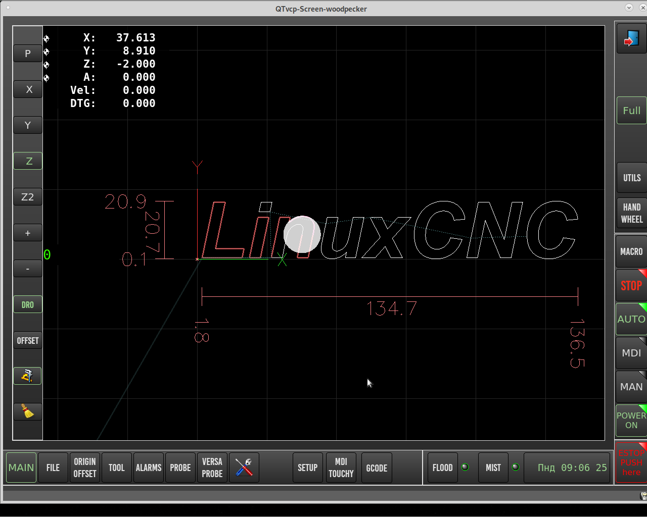

12 Apr 2021 01:12 #205700
by hottabich
Replied by hottabich on topic Cone Transparency
QtDragon or Woodpecker after dro activation in gcodegraphics the cone is transparent.
