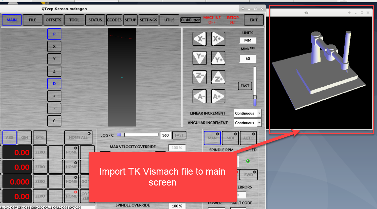

Hi all,
I want to import the scara TK vismach to main_tab of qtvcp screen.
I am using this config, but it doesn't work.
Can you help me check it, or give me the manual to build it?
thanks
[DISPLAY]
DISPLAY = qtvcp /home/mwork/mdragon/mdragon
EMBED_TAB_NAME = 3d
EMBED_TAB_LOCATION = main_tab_widget
EMBED_TAB_COMMAND = halcmd loadusr scaragui
thanks

TK objects are not embed-able.
If you are using master branch, there is a qt version of vismach.
open a terminal add run the command:
qtvcp vismach_mill_xyz
This is the only example, you would need to convert any other tk samples.

i tried to add this code to show vimach to dragon gui
any info about qt_vismach for scara machine
thanks
Can I use TK objects (SCARA ) to show?from qtvcp.lib.qt_vismach import mill_xyz as MILL
def initialized__(self):
machine = MILL.Window()
self.w.xxxx.addWidget(machine)
thanks
- Posts: 7368
- Thank you received: 2181
23 Aug 2021 04:28 #218460
Replied by cmorley on topic import TK vismach to QTVCP
There are no docs other then the comments in source code:
github.com/LinuxCNC/linuxcnc/blob/master..._vismach/mill_xyz.py
You could look at the tk vismach mill_xyv to see the differences.
You would have to convert the tk scara to work with the qt version.

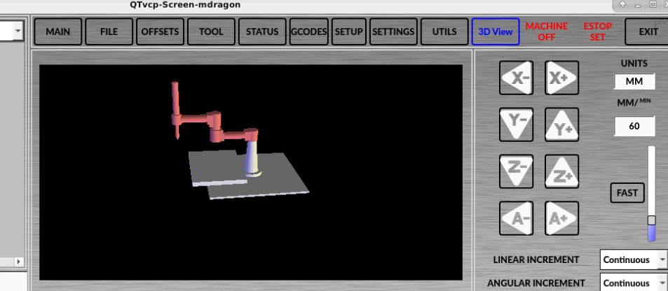

25 Aug 2021 08:41 - 01 Sep 2021 12:42 #218689
by nhanpham
Replied by nhanpham on topic import TK vismach to QTVCP
ok, thank you very much.
I modified the python file and add it to the lib folder. It works well.

if __name__ == '__main__':
from PyQt5.QtWidgets import (QApplication, QWidget)
app = QApplication(sys.argv)
window = Window()
window.show()
sys.exit(app.exec_())

26 Aug 2021 01:53 #218750
Excellent!
If you don't mind I will add this to the project.
Chris
Chris

ok, you can use this code to add demo for anyone
