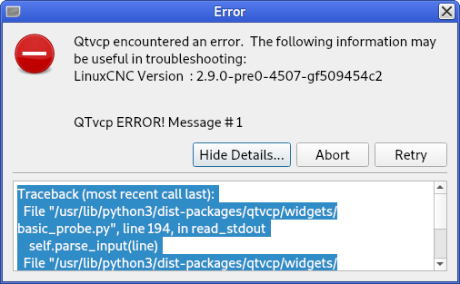

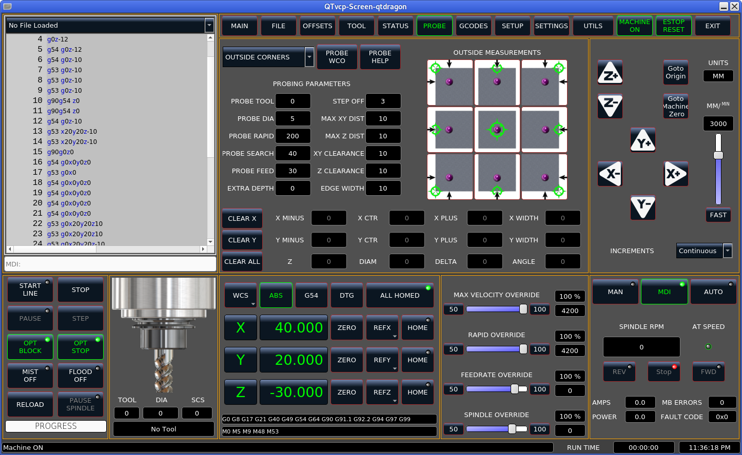

Hi all
I am starting to play around with the probe screens in QtDragon & I am using the latest development version.
Every time I try to do the center probe it crashes and gives a python error.
I have posted the error in the hope that someone understands what this means.
I have also posted a screen shot of what I was doing at the time.

Replied by cmorley on topic QtDragon & probe routines (crashing)
I pushed a (hopeful) fix for this. I don't have a probe handy to truly test properly, so there may be others.
Thanks for reporting.

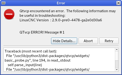

Hi there
I have done an update, but it appears the same error is still occurring. I have again attached screen shots & a copy of the error.
Please let me know if there is anything further I can do.

Chris, I don't think you ever pushed the updates I gave you a few months ago. However, these errors seem to be related to python3.

Just to let you know that I have tried it with the latest update (pre0.4513) & that seems to be working.
