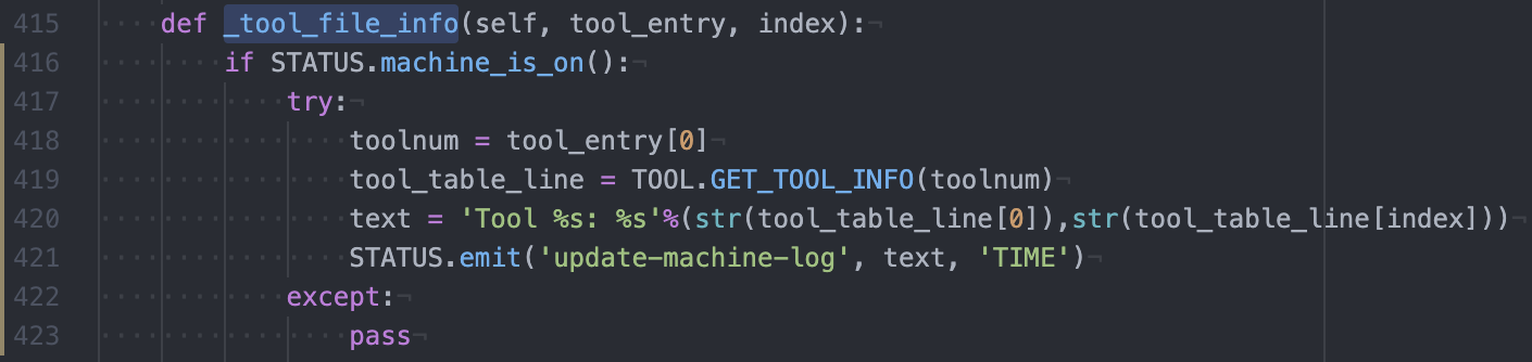

02 Sep 2021 00:07 #219376 by phillc54
Replied by phillc54 on topic Machine Log
Following the yellow brick road shows that the log is updated for tools at line 485 of screen_options.py. If I make that dependent on the machine power status then it doesn't log the initial tool state. It is probably only a kludge though.

02 Sep 2021 02:23 #219388 by cmorley
Replied by cmorley on topic Machine Log
That seems a pretty reasonable way to go.
You can also add a tool -1 to the tool file and get another answer.
Though the default 'no tool' comes from qt_tstat.py when one asks for info on a tool not in the toolfile.
I defaults to all tool 0, all data zero and the comment 'No Tool' I guess it should default to current tool - then it would be -1 on start up.
It's strange that no one has officially made linuxcnc remember the last tool it used before shutdown.
I would have thought it reasonably simple for a dev who knows the code.
I never did understand the T0-can-mean-different-things problem either. - it messes up lathes too (T0 is a valid number usually)
