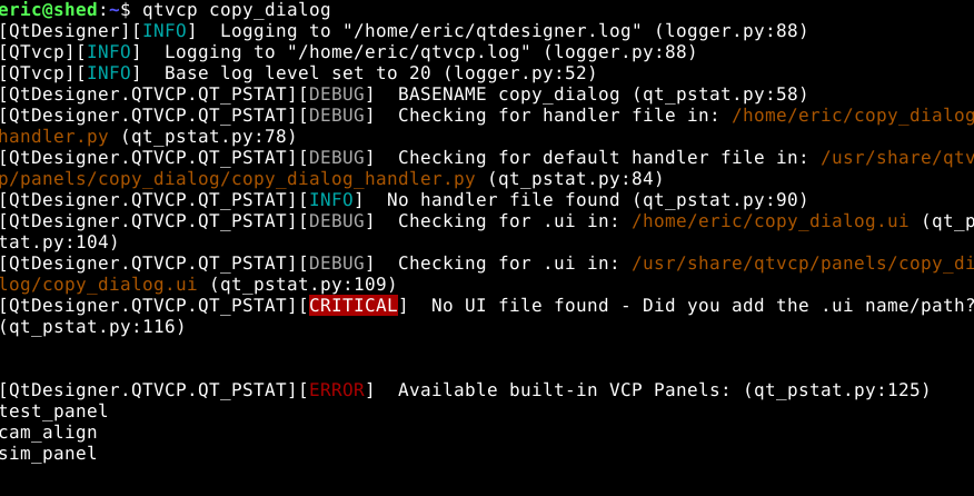

I do have a specific questions thanks Chris, attached is a screenshot of the response I got from invoking the qtvcp copy_dialog command ,
is there something else I should be doing/installing?
Eric
edit: I am using LCNC ver 2.8.2

Replied by cmorley on topic is there a qtdragon dummies guide for beginners
copy_dialog is not available in 2.8.x

Replied by ericg on topic is there a qtdragon dummies guide for beginners
Thanks Chris, I suspected that, I'm going to put this aside until I get around to updating LCNC.
