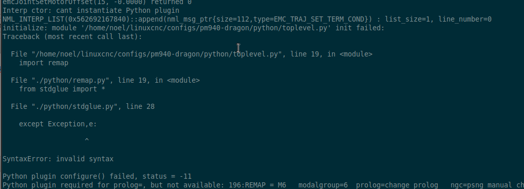

stdglue.py error ??????? was created by Roguish
Ok, installing qtvcp with dragon on master linuxcnc.  so far, sort of ok, but I get a weird error on loading....
what's up????
running:  Linux hectron 4.19.0-17-rt-amd64 #1 SMP PREEMPT RT Debian 4.19.194-3 (2021-07-18) x86_64 GNU/Linux
and:  LINUXCNC - 2.9.0-pre0-4694-g69a1f7d90
and:  versaprobe

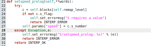

Replied by cmorley on topic stdglue.py error ???????
That file is using python 2 code,. python 3 requires
except Exception as e:
