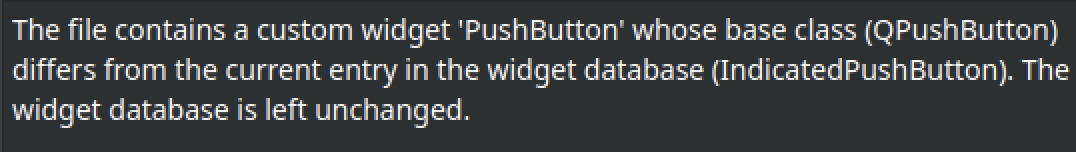

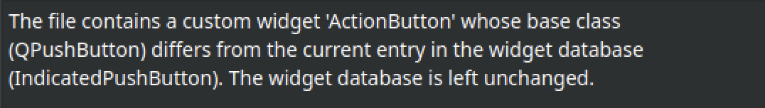

SOLVED - Designer Warnings For Custom Widgets was created by phillc54

Yes I changed the baseclass of Pushbutton so you get that warning untill you save.
Sorry for not posting about it beforehand.
